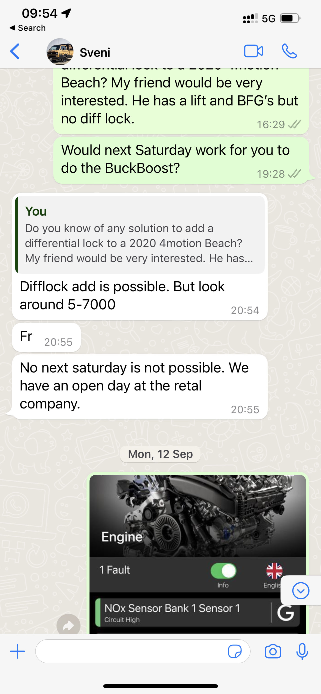

I have an excellent mechanic in Switzerland they can retrofit a diff lock. Price is high though at between 5-7K CHF.
I have t6.1 4 motion with rear diff lock, the haldex system is very clever and works great but i have to say im really glad i optioned the diff lock, it already got me out of incredibly stupid choice of road, i was stunned by the difference it made in traction with it on, its clearly a must have to the more adventurous of california owners
I'm also looking into options for adding a rear diff lock. Is it possible to get a contact of this mechanic? I might spend sometime later this year in Switzerland.
Sure thing, ask for Sven Fischer and tell him Craig sent you:
