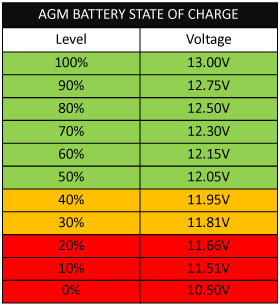

You have in fact used 40% overnight.
Will the real "State of Charge" chart please stand up. I got this version from this forum as well. @WelshGas version tallies with the battery readings on my control panel for the past 3 days.

Either way my 11.5V charge was in the red zone. And the % figures do approximately tally with the chart. I would argue the 12.6 to 12.2 could count as 20% drop but it’s all an approximation. The fridge is currently on so not technically ‘at rest’.

You would need to turn the fridge off and wait a short while to do the reading. The current for the fridge can pull the reading down by 0.1 or 0.2 which on your chart would make a huge difference to your percentage use.

From my understanding, determining the battery charge % level by reading the voltage has to be done with no load.
That is, turn off all current draining devices, including the fridge, and then check the battery voltage level.
Under load the battery voltage will show lower and sometimes significantly lower than without load.
Well after 5 days and 4 nights it shows 12.3V and 70% ten minutes after turning the fridge off. Exactly like the above charts.
