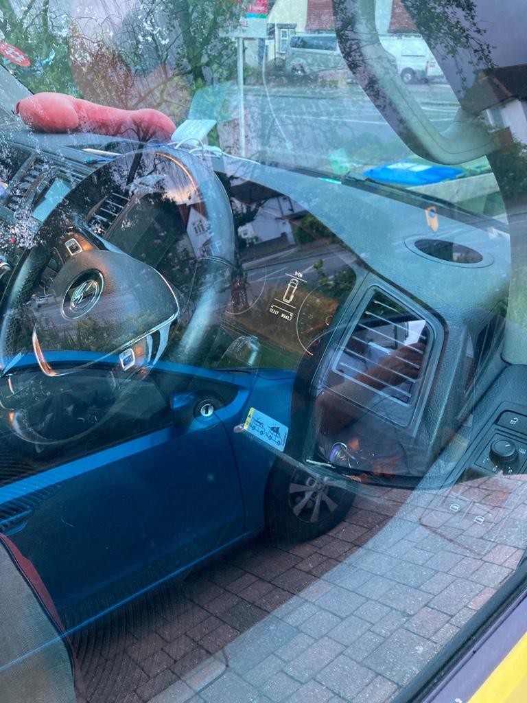

If the Dashboard lights up, then yes, the vehicle probably is being primed. I don’t believe that happens on mine, but I can’t check at the moment.
Just checked. Single fob press unlocks the front door only, double press unlocks the passenger doors and boot. Neither light up the dashboard.
Opening the manual sliding door lights up the dashboard, which shows that a door is open and gives time, odometer and trip mileage. See pic. I think it also turns on the USB port for the entertainment system, because if my iPod is plugged in that lights up too! (I usually remember to unplug it).
We do use the top of the dash cigar socket for USB charging while camping - but I think that is leisure battery.
We rarely use the front of the dash cigar lighter, and never when camped. We used to have a little cigar torch plugged into it, but that got lost several years ago.
