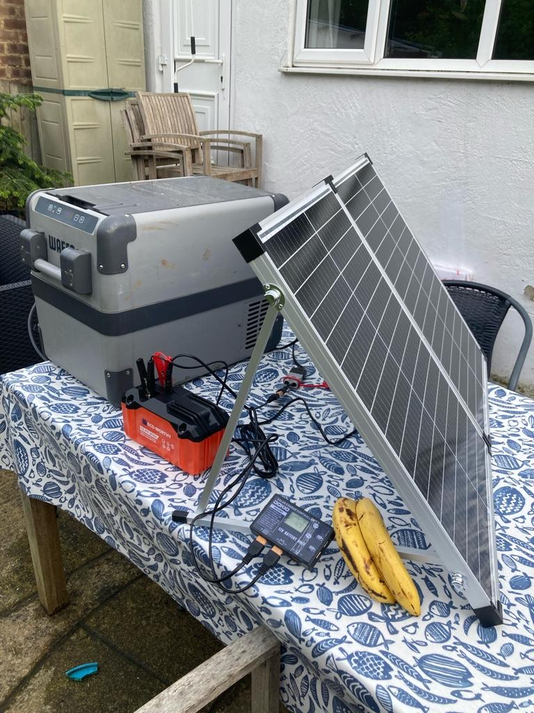

A temporary solution will be to trickle charge the engine battery (either the current one or a new one) with my folding solar panel and its cheap solar charger.
It’s only an urban legend that 2 bananas near a solar panel help it charge. The Mythbusters team disproved it a few years ago.
I like the way you put the bananas there so we could get a sense of scale

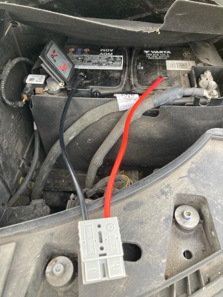

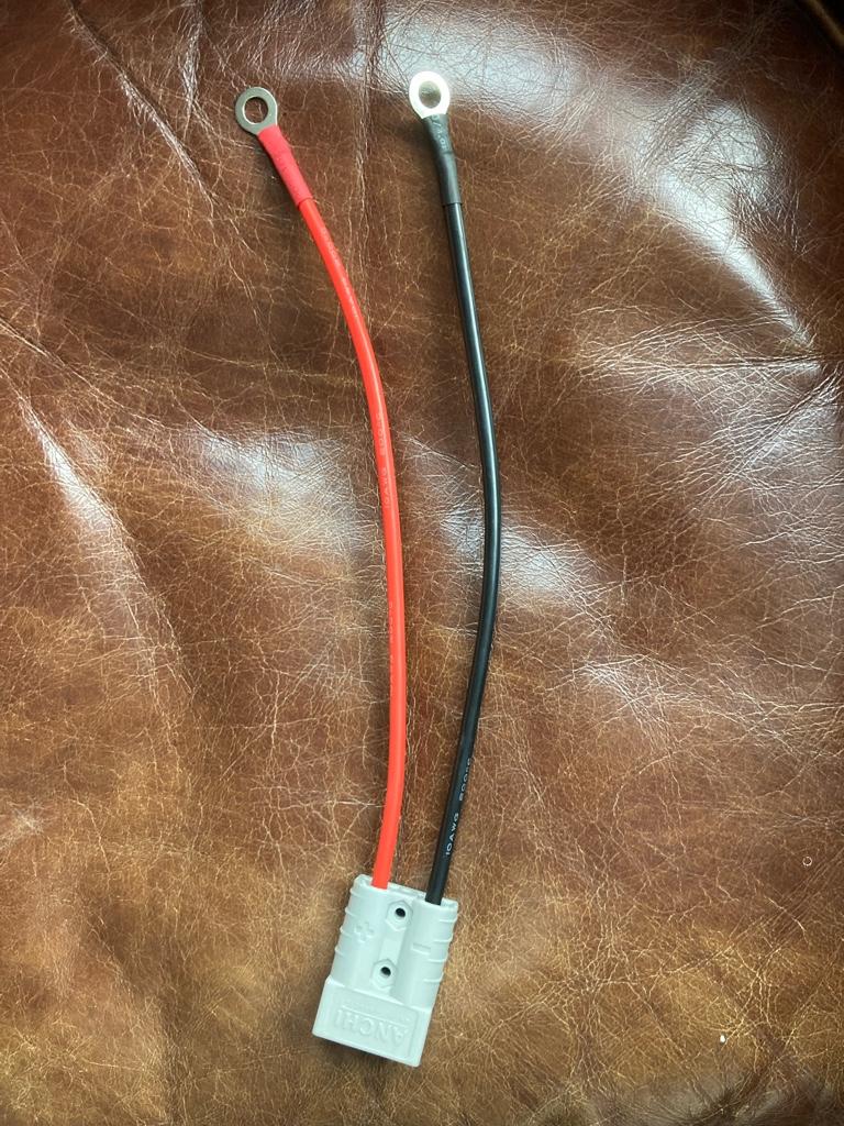

As a mid-term solution to the problem of my starter battery flattening when camping for five days or longer I am going to attach a battery to Anderson lead to my starter battery.
I am also upgrading my solar charger to a dual battery solar charger. This will deliver 1amp to the starter battery once the leisure battery is charged. Sufficient, I hope, to prevent the starter battery from draining when camping.
For now, as a mid term measure, the starter battery will not be permanently connected to the solar charger, only while camping via a 5m cable from the charger in the boot tool compartment to under the bonnet. Certainly not ideal, but functional.
My question to the group is this: is it perfectly safe to attach the black ring terminal to the -ve battery terminal? Or should the black ring terminal be attached to earth as you would if jump starting?
I’m pretty sure it is safe as it will only carry one amp, but I’d rather check and look ignorant than not check and be sorry for not checking later.
I will test the system this summer with the old battery when camping before replacing the battery.
My eventual aim is to permanently connect the solar charger to the starter battery via the cables under the front passenger seat.

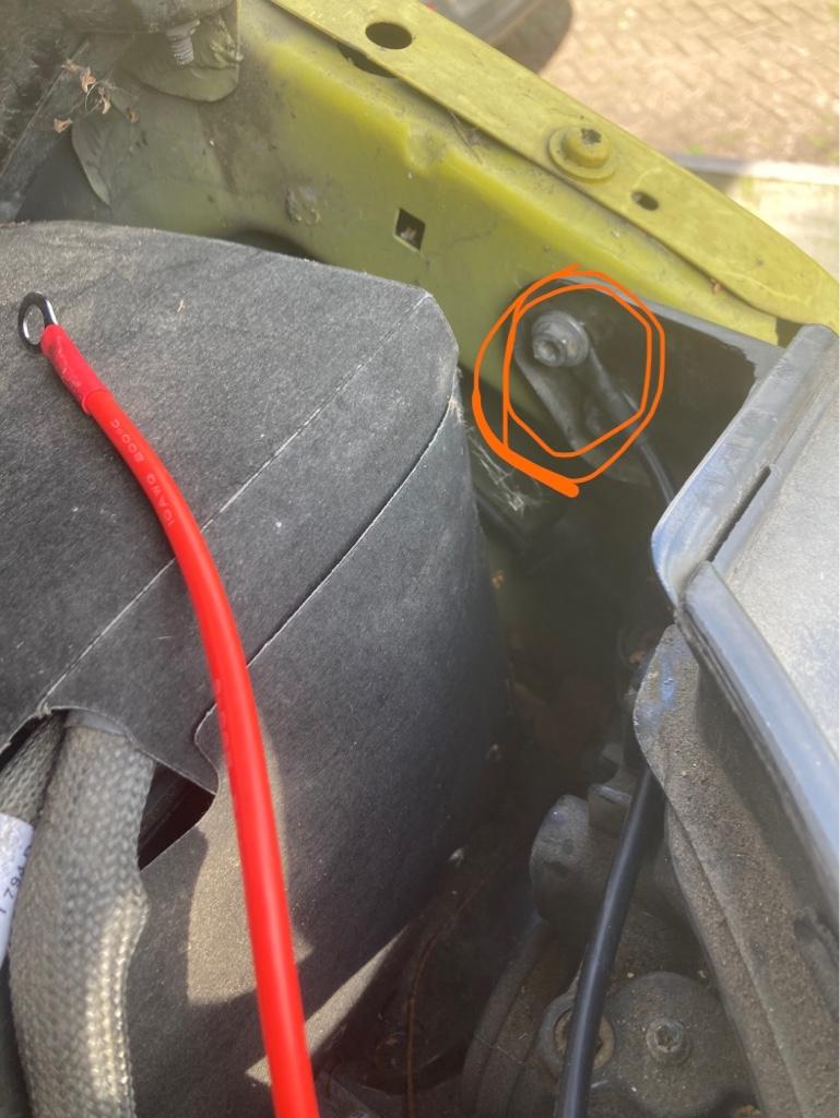

Will this suffice (circled in orange) given that that the eyelet leads are so short?
Clean the bolt and the area of metal with fine emery paper before fixing, use a crinkle or star washer between metal face and crimp eyelet, tighten bolt and put a dab of vaseline petroleum jelly over connection to inhibit water ingress and corrosion.
Thanks. I have followed your recommendations, and have now fitted and tested the Anderson connector with a 12v led light. It works. I’ve also put in a 10amp fuse on the +ve connection.
I don’t yet have the upgraded solar charger, but do have the 5m Anderson lead. I am happy to report that it will extend externally from the boot tool box, out through the tailgate, above the unused kador attachment rail and then into the bonnet, all unobtrusive and easy to attach.
I’m so glad I asked what I thought was a stupid question about connecting to the -ve battery pole.
Where have you put the fuse on the positive lead? my preference on any lead that could supply power from either end would be to use two fuses, one at each end. If you do only put it one end I would go between the Anderson connector & the battery.
