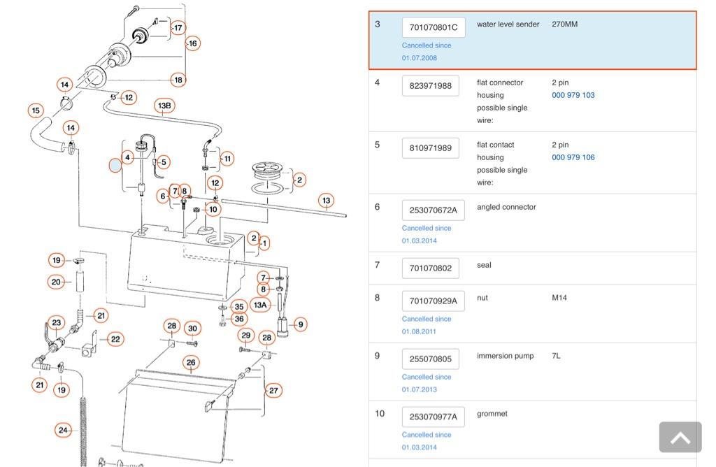

My van is from 2001, with the tank in the left hand side, inside the wardrobe.
It's the length of the sensor I'm questioning. It doesn't seem long enough to be giving a reflection of the actual water level...
I wouldn't have questioned it as it is the same part number, but the guy I bought it from did have a couple of variations, longer versions different part numbers (one was quoted as being for an Exclusive, but indeed there were 2 listed for California, the part I needed and a longer one - same fittings).

There me be measurements on the gunzl site.
Chris
According to the official diagram it should be 270mm…
Well ok, then it's right - thanks for the info...
