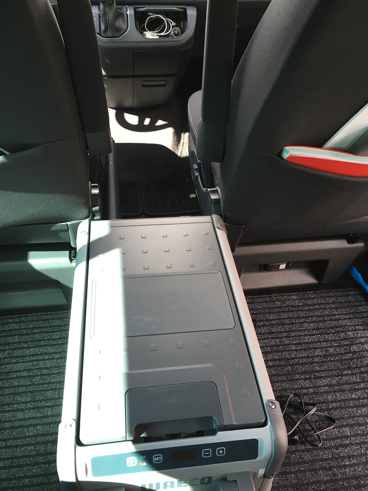

Please some pictures of CFX 28 between front seats :)
I recieved my CFX 28 today. I can safely say it is impossible to fit between front seats:

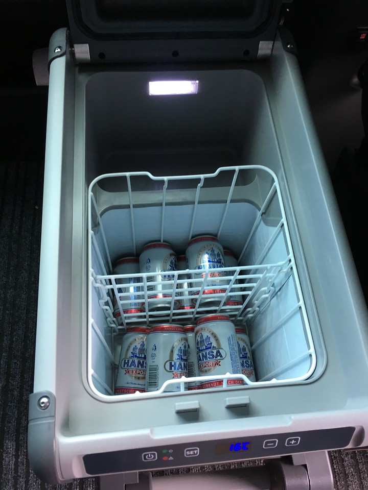

Its sunny and 18 degrees outside today. I have the battery full.
I put some room tempered "food" into the fridge and set the battery protection to low to see how long it will operate.
Temperature set to 5 C.

I have had my CFX28 connected for 24 hours now, the battery reads 12.4, dropped from 12.9 when I started the fridge 24 hours ago.
Fridge stopped on medium protection at 12.4V after 30 hours of 5C degrees.
I measured with three voltmeters. When I set the fridge to low protection and the compressor started it went down to 12.2V
I hoped the beach could sustain the most the most energy efficient coolbox safely much more than 24 hours.
