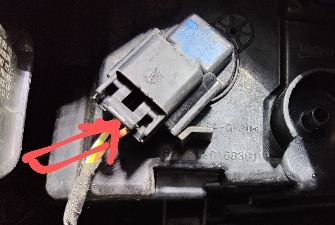

Hi - sorry to wake this thread up but I think I'm having the same issue. On my 6.1 the bulb setup is slightly different to the pic above - it seems to have a clip attached to it's back. Crap pic attached. I haven't tried really forcing it yet as it's not clear if it's part of the unit or not - but has anyone come across this type yet, and how does it come off? Frustrating!!

It looks like there's a little post stopping it from rotating any further anticlockwise though?

All sorted now - it was different for each side but unplugging the bulb first was the key. (Push the tab down whilst pulling out he plug out)
On the off side, this enabled the bulb to twist past the projecting plastic piece (under yellow arrow in original posted pic) and come out as it should, on the near side there was no obstruction stopping it twisting, although there was a lot of stuff going on in there already...!

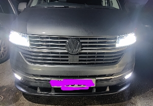

One more post to close it off. Before and after shots - the difference as they say, is night and day! I'm not actually too bothered about the fog light use as I think they may be quite bright - but at least everything's the same colour now when the cornering light comes on.
