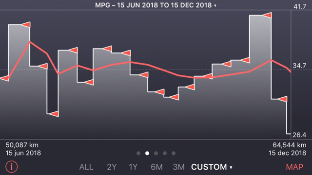

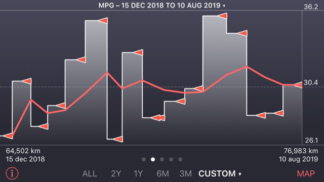

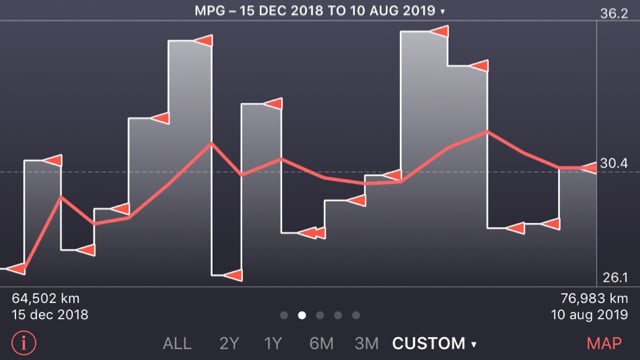

My long term average is 33.8 mpg, and has taken a big hit since changing wheels and tyres from the 16” Beach standard to the 17” Ocean standard wheels in December 2018.
I was just curious why the wheel change had impacted your consumption. The 17s come with either 215s or 235s wide tyres. I’ve been running the 215s which run at 10 psi higher than the 235s giving quite a hard ride, but thought they may be giving me better consumption
I was wonder if your dip in consumption was because you’d gone to the 235s.
The tyres are 235.
That aligns with my theory. I'm running the 215s and have a spare set in the wings, but beginning to think I should have bet on the 235s for their lower pressures and I guess less harsh ride.
At least if I'm saving fuel then I see one upside.
Looking only at the figures since we returned from our continental tour, the hit appears to be 4.3 mpg. However, the new tyres did almost coincide with a service when they tweaked the way AdBlue is used, so the hit might not be caused by the tyres alone or at all.
