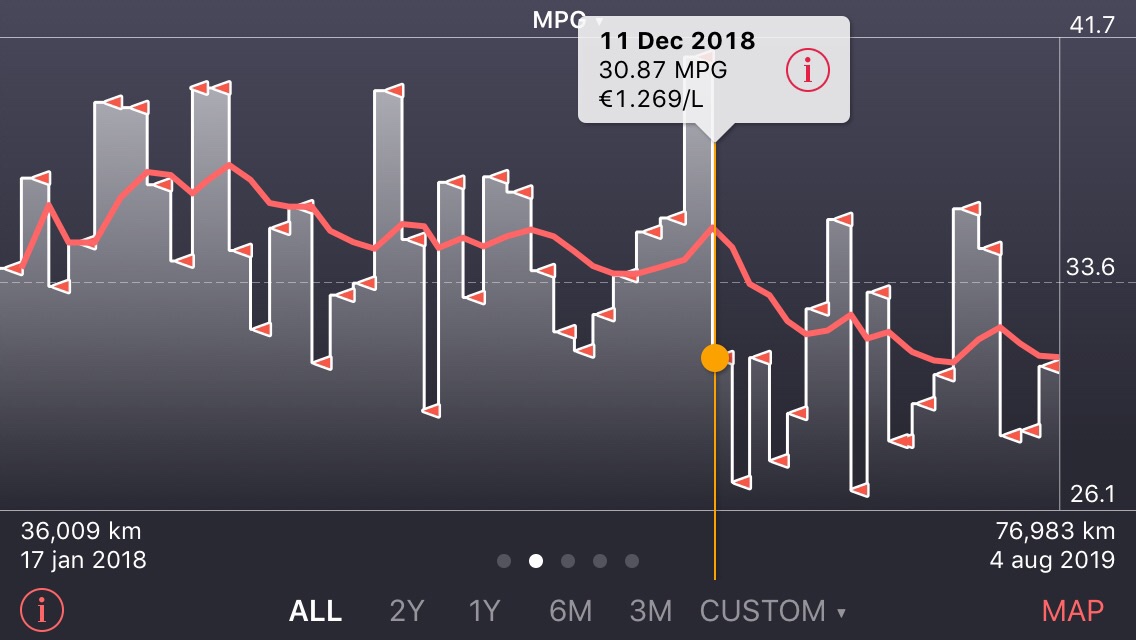

Luckily I have never faced that light up to this date, but my T5.1 had an engine update to regenerate more often, even on lower distances.
The only moment I can feel it regenerates is when driving on a highway on cruise control, when suddenly it feels like the engine somewhat cutting in, and then just continues like normal, a couple of times in a row.
And for the fuel consumption, mine is at a steady 7,7 liters / 100km (30,5 mpg?) all mixed together. And that is as stated by VW.
On journeys, it drops to 7 - 6,5 l/100 km (33,6 - 36 mpg?).
I use Fuelio for tracking that.
