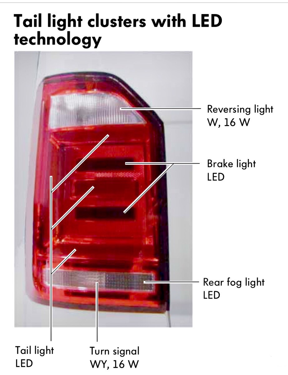

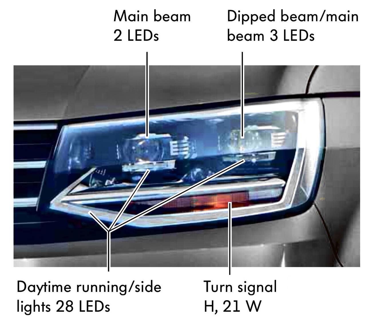

Bulb kit is handy to show but the bulbs you can change if you have LED are as per pics so I carry those as spares.

Thank you for this. May I ask Mike how many bulbs that I will need and can I buy a kit. I too have LED lights. Sorry I’m not very knowledgable about these things. Heading to France in a few weeks so just getting things together. Also any ideas about the best place to buy them. Thank you Jo
No problem. As you can’t do anything about the LED’s it’s just a case of a H 21 W for the front turn signal, the W 16W reversing light and the WY 16W rear turn signal. I don’t know about any kit on the market.,

Thank you Mike. Sorry I’m being dim but how many bulbs is that altogether ? Is it two of each that you mentioned. Thanks again this is really helpful.
You will be unlucky if more than 1 goes. I picked up 2 of each off Amazon.
