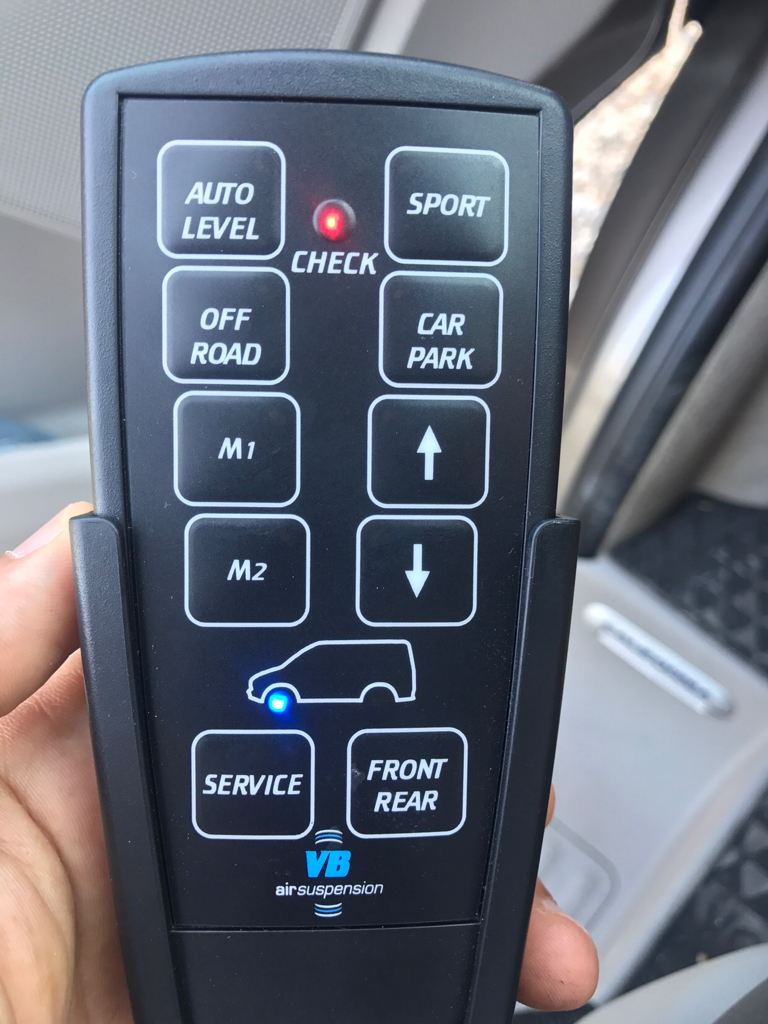

Hi everybody,
After driving 1000km+ with the air suspension installed all seemed ok except this morning when i've started the car i've got an error from air suspension. The red light was flasing and the remote beeping.
after that the remote sets to error (red light flashing) and the "down" error stays with light on.
can you please advise me?
thank you!
You probably got a battery voltage warning. It is set very safe so that it never goes low. You should always operate it with engine running except for self leveling. To see what error it is press service and look at the lights. Then look in the manual.

Hi, indeed it was a low voltage problem. Somehow the threshold at witch compressor disconnects was to high (12.5V). They put it lower and looks fine now.
I left it there, just never operate the air suspension without engine running, except for lowering (loading stuff) or self leveling, both cases in which the compressor has no work.
