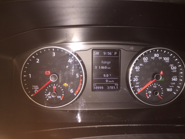

On a very recent 400 mile round trip, across the centre of.Sicily, then along the southern coast, I managed 49.2 MPG on a brim to brim measurement; the MFD boasted 51.4 MPG. This was in an empty van with no bikes.
Our long term average is 43.5 MPG on the MFD in a full 150 DSG Beach with bikes, but I do drive slowly - usually under 60 MPH - unless I have a good reason for going faster.
After one refuel we had a range estimate of over 900 miles!

Be aware that the Trip 2 (long term) MFD resets every 100 hours (or 9,999 Km) of ignition on. Our reading of 43.5 MPG is over the last ~80 hours only.
