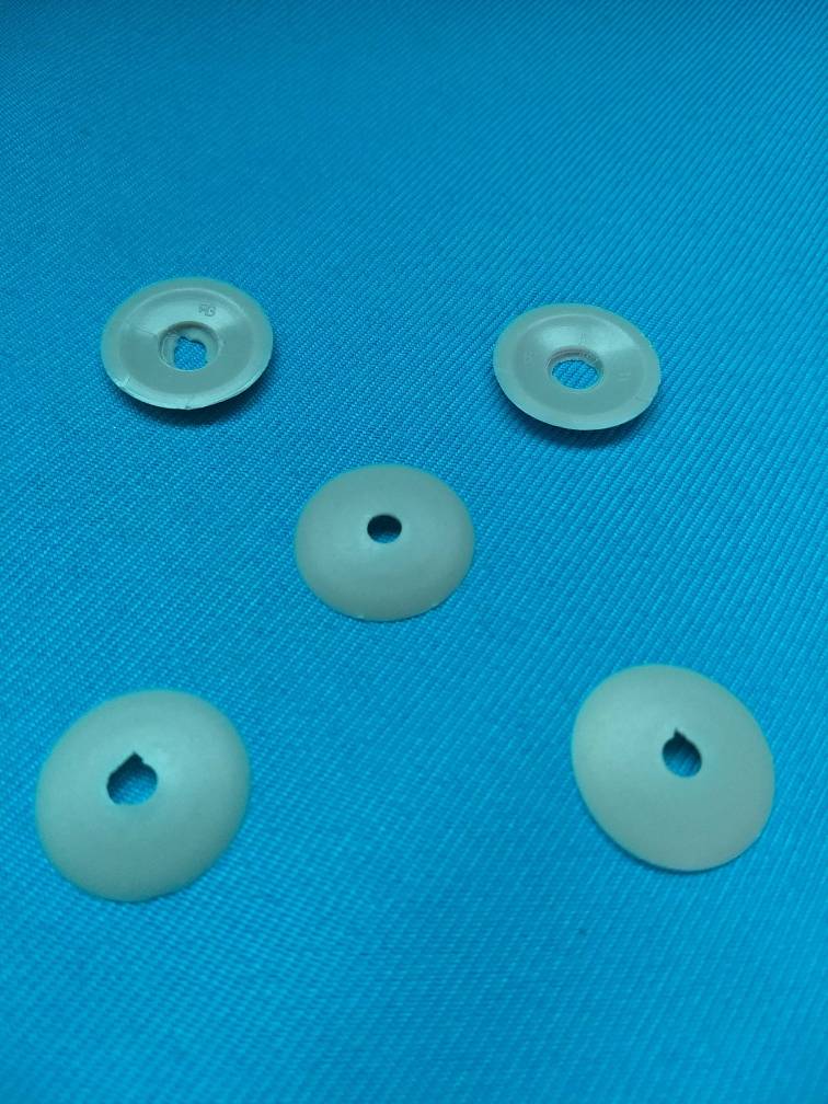

Does anyone know the part number for replacements, ThanksWhilst trying to identify a creak/rattle whilst driving rough roads from somewhere on the NS behind the passenger seat at about worktop to head height, (possibly from behind the kitchen lighting panel), I found these grey plastic discs.
I lifted the roof and found them on the van roof perimeter next to the bed, just over the kitchen area 2x on the NS & 1x on the OS above the door.
Any ideas what they are off?? & should I be worried? :boohoo
Sorry for piccy quality as it's off an old phone.
VW gave me a bag of replacements and I just replace when the "washers" appear. Only used one so far.
I’ve lost four in 6 months and the headlining now rattles. Unsure if removing the bellows is nessesary....or is it??
Has anybody found a home made fix??
Any idea of the part number? I've searched and totally failed to find the part.I bought some from TPS, replaced them did not have to remove the bellows. Just push the inner bit in and knock a new one in.
I’ve just ordered some 65p each from Southern Motor Group Cowfold,here is the picture of the part number.I hope they are easy to fit,my warranty expired last month.The hard bit is apparently getting the old broken section out which you can do by screwing in a small self tapping screwI popped into Breeze in Poole because I was passing hoping I might be able pickup up some. I was told they cost some rediculous amount.

Hi Billywizz, do the VW panel clips fit exactly like the original (useless) ones ?I replaced mine with these, far far betterView attachment 47361
They fit better, a perfect fit and I’d even go to say it’s a permanent fix It took me all of 15 mins to complete.Hi Billywizz, do the VW panel clips fit exactly like the original (useless) ones ?
I.e exactly the same hole size ?
Where do you get them from please?Hi Billywizz, do the VW panel clips fit exactly like the original (useless) ones ?
