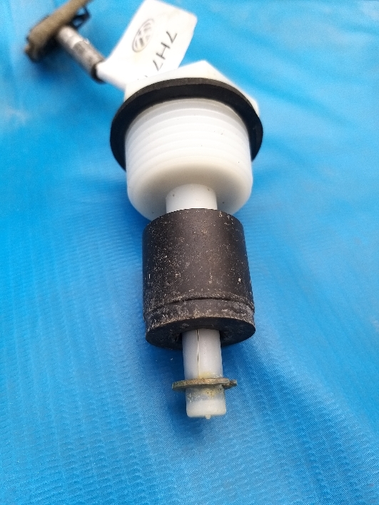

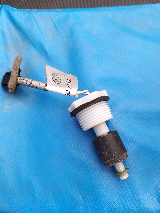

Grey waste tank sensor
Found it... What do you think does that little crack suggest i Need to change It because the tank is empty but shows one line full?
Sent from my SM-A920F using Tapatalk
Up to you really. The waste sensor is not that accurate. As long as the black float moves freely you could leave it.
Ok thank you for advice
Last question please forgive me. how many line tacks should the display on control panel read on this sensor? Zero for empty? And full how many? I now have one tack and the tank is empty?
Yes, needs replacing, the crack has allowed water to corrode the internal microswitches. The float has a magnet in it that operates the 2 microswitches.
