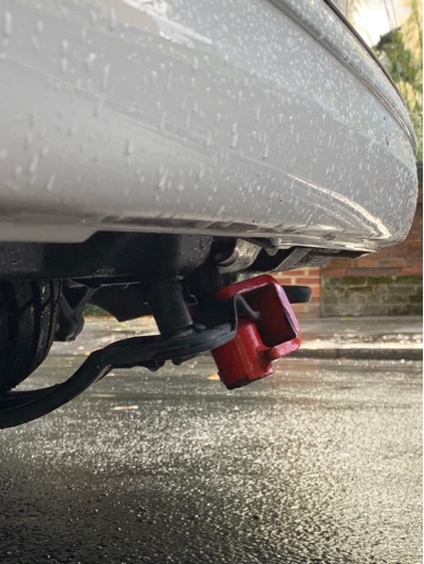

I’ve badly grounded twice on drop kerbs after fitting a 17” spare wheel and a sparesafe. I was not heavily loaded, though admit I did pull away sharply. I initially thought it was a drawback of the sparesafe but it’s just occurred to me that the spare may be too wide. It’s a 235/45 r17 and I guess it should be a 215/60 r17 which is 20mm thinner but can anyone confirm what size VW supply. Also, has anyone experienced this issue?
My next job is trying to straighten and remove the bolt as the sparesafe has twisted.it.

Mine grounded badly last week going into a driveway and seems to have badly bent the sparsafe bolts or whatever the bolts fit into. I’m plucking up the courage to actually see how bad it is or if I can still get the bolts out. That’s with B14s on 4motion unloaded. Prior to this it occasionally caught when exiting a speed bump but not badly. I’d like to say the noise it makes means you only ever do it once but I did it twice

No I don’t get it either and I’m still trying to understand why it happened (twice) when not heavily loaded. Hence my original enquiry whether it’s commonplace. I’m going to measure the distance and ask for comparisons. Plus, I’ll video it doing down one of the kerbs where it happened (once I’ve straightened the bolt up).
Many of my local roads are very cambered down to the edges and then entrances to driveways rise up from that... so pulling into driveways the front is rising 40cm or more as the rear is dropping the same simultaneously. Makes grounding surprisingly easy.
Make that 4 times. Very bent now.

It’s not kerbs, it’s heavily cambered streets that drop down at the gutter then rise steeply a cross the pavement into a drive or entrance. I used to own a Sports Car and that would ground the front on these too. Will find a pic and post.
