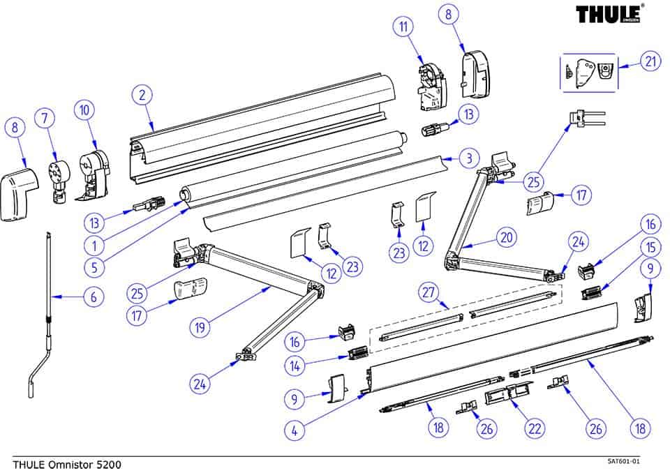

VW will only replace the whole awning, whether within or outside the warranty period.
Rose Awnings will supply spare parts and may be able to give information on companies who can fit. But it won't be VW Dealerships.

Replacing the fabric is quite straightforward, provided you have a few pairs of hands for an hour (three, ideally four people) and take photo's of every piece as it's removed, if you drop anything highlight it as possibly needing switching round.
It may assist to have a big piece of cardboard which you can cut & push each piece removed into / draw the shape / direction of every part and spacer as you take it out perhaps you won't spend an hour trying to put back something with a spacer the wrong way round as I did.
n.b. Slower free postage option isn't available on this oversized package - although the website doesn't show that.

The Thule interpretation of a “Weld” and the public interpretation is not the same. A weld is where the 2 pieces are actually fused together and cannot physically come apart without destroying them. These are actually glued together and when very hot the glue can go soft and the two pieces come apart leaving the stringy glue stuck to one side only or dangling in mid air.
