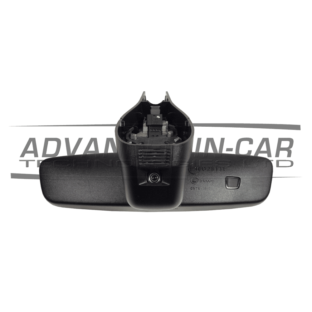

I found some info. Maybe try it out? But you have to be on very dark roads for it to work properly.
It says:
"High Beam Assist allows your Transporter to Automatically turn the High Beam On and Off when driving at night when your vehicle detects an oncoming vehicle.
This system dips your high beam automatically to improve driver control and safety for both the driver and other road users. The system is automatically activated when travelling over 37mph with your dipped beams on. Using a camera built into the rear-view mirror, the system automatically dips the headlights when it detects either oncoming traffic or vehicles ahead. It is easier than constantly switching from high to dipped beam and safer too, giving you the best view of the road ahead without dazzling other road users."
