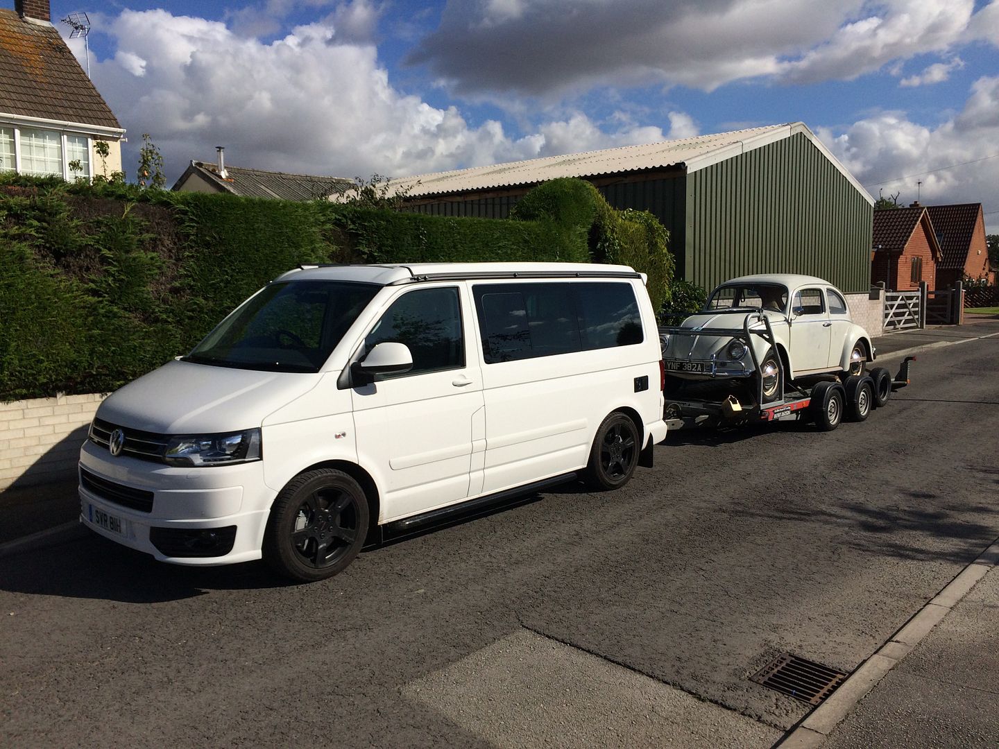

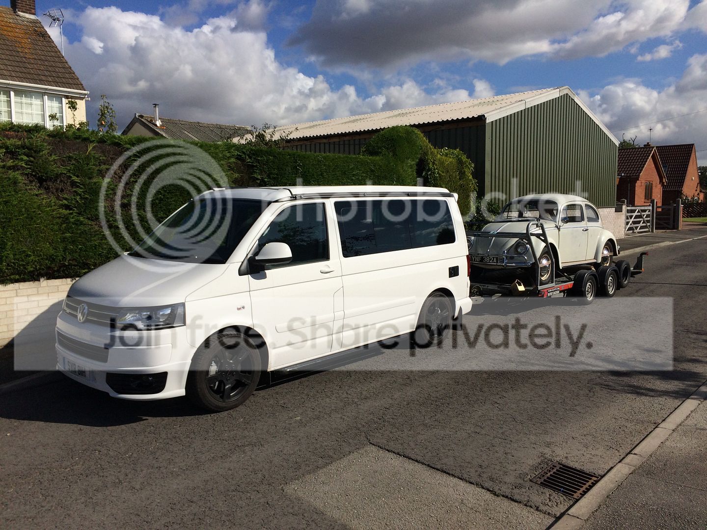

My 180PS SE (not 4 motion) had a factory det towbar with the Heavy Duty Stabilisers and I had Sportline Springs and 18" Sportline Alloys. It towed amazingly and felt absolutely rock solid. I think if any when I get around to putting them on my Ocean I will fit the stabilisers too.. I did find a guide with part numbers before but I can't remember where I saw it
