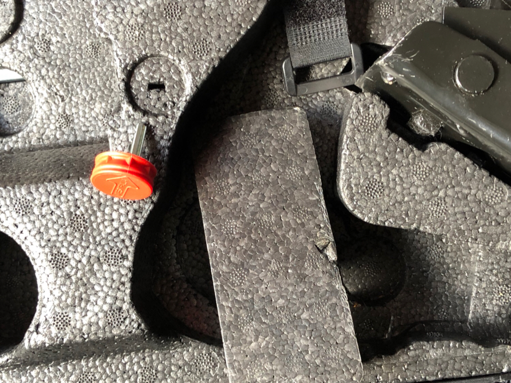

Mine is a removable factory fit and when not in use it lives in the toolbox along with the key. Might be worth a look in there.
Mike
Mike
Thanks for the suggestion! Sadly it wasn't in the toolkit.
