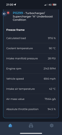

My carista device turned up today so decided to boot it and find the code, turns out its P0299 Underboost. I guess i have a turbo leak somewhere, which explains a possible lack in power. Ill have a better look tomorrow, the garage did check for oil, exhaust and fuel leaks but found nothing. Unsure if they would have checked for turbo leaks.
2 questions if possible -
- has anyone here solved this code on a 2.5 174?
- i bought the van second hand, it had a recon turbo fitted in Feb (as part of the big bill), do i have any rights to ask the original garage to fix the issue?
thanks!
thanks!

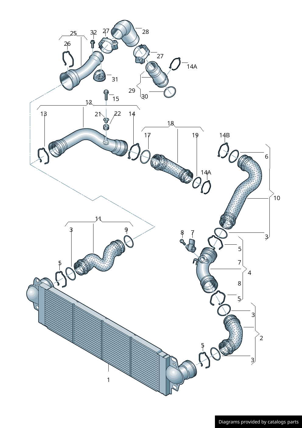

Before focusing on the Turbo you should check the pipe work relating to the Intercooler and the intercooler itself for damage causing an air leak.
versa.
thanks, thats really useful, can i inspect most of this under the bonnet or do i need to start removing things? Ill have a hunt around the engine bay this weekend
I’m sorry I have no personal knowledge of your engine. But I would start at the Air box and just work my way round the pipe work. The connections to the turbo have obviously been disconnected/connected with the turbo replacement and the Intercooler is prone to damage.
It is positioned in front of the lower part of the radiator.
I know you said you replaced the moo valve , look at the part the moo valve is directly connected to . It's turbo related
Sorry I've had a bit of Wine so can't be more specific :cheers
Everything you describe sounds to me like you have a leak in the pipework.
If you have a local turbo specialist or good mechanic they should be able to find it.
Air intake and exhaust for the turbo are common culprits in my experience especially after the turbo has been replaced.
