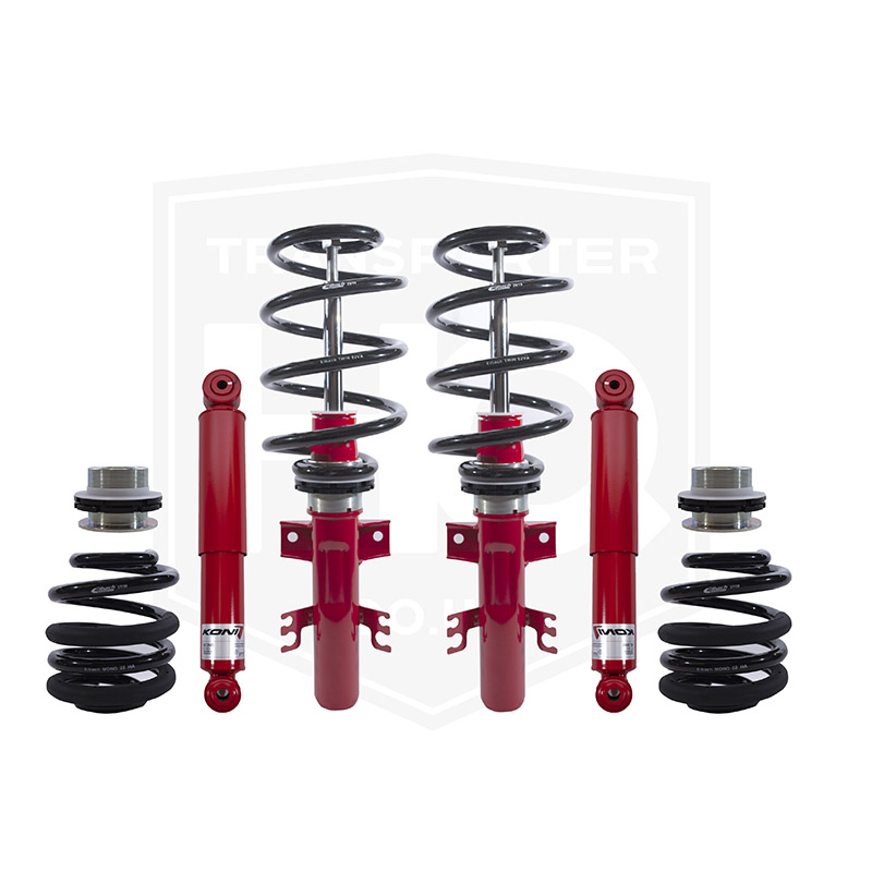

I have also been told coilovers will significantly improve the ride (and permit lowering by up to 70mm). These have been recommended. Like I say, I don’t think the 150 6.1 ride needs improvement... but would like to drive a coilovered 150 to compare...
VW Transporter T5/T6 - Twin-Adjust-Projekt - Sensitiv - Komfort - Coilover Kit - T26/T28/T30
Although not as well known as companies like Eibach or Bilstein,Twin-Adjust-Projekt make some truly impressive suspension products, like this!transporterhq.co.uk
