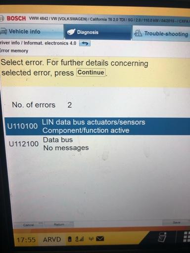

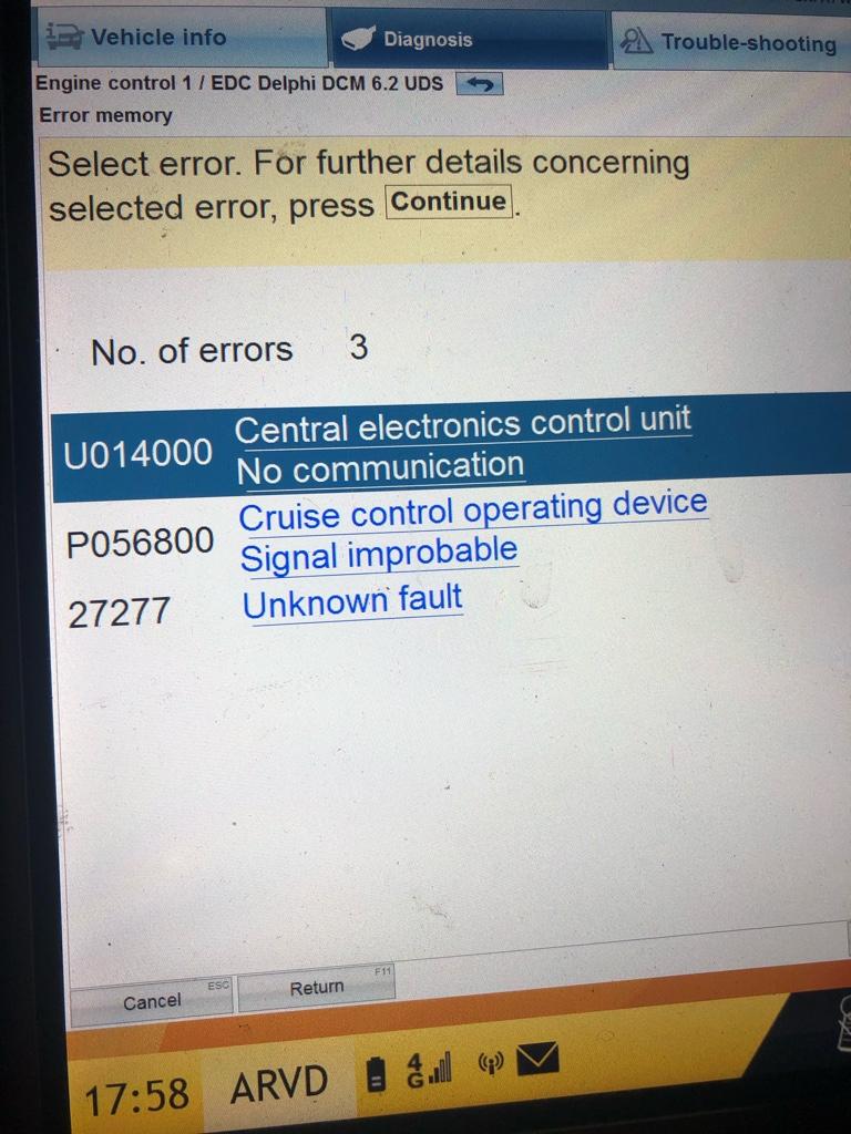

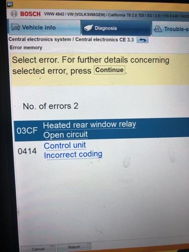

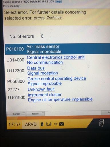

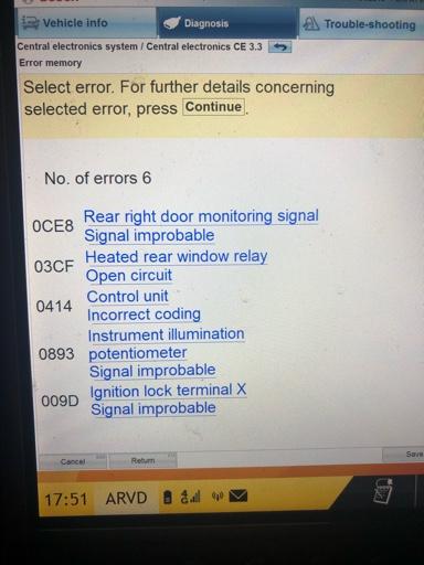

Thanks for the ideas and questions - yes it all just happened today at the same time. Yesterday all was normal. No signs of damp or rodents , although can never be sure! AA guy told me to leave it with earth off overnight and said there was a chance I could be lucky - but most likely not. A lot of the errors were temporary but the ‘incorrect coding’ is the one he (his diagnostic iPad!) thinks is the cause. Let’s see...

The Delphi diagnostics unit is a generalised quality garage tool for all brands of vehicle, so is likely only pulling down the error codes and interpreting them. Whereas VCDS is specific to VW group vehicles only.
As others have suggested, issues with the battery can generate erroneous errors.

Thanks for all the advice. To conclude things, Cordwallis VW solved it today. As the AA man suspected, the BCM had lost coding. They reprogrammed it and all works fine. Hope it stays that way!
