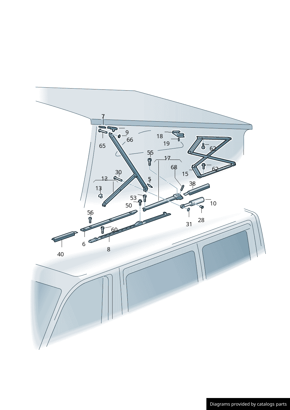

Hi, can anyone help with what these little rubber stoppers / grommets are please? One was sitting either side on the front slope down arm of the pop top roof.
Van had gone in for some work and these were sitting in the arm once we opened the roof at home. Thanks
They fit into the small holes on the roof support arms.
For me, I found the drivers side one sitting in the gully of the awning and the passenger side is completely missing. Looks like another couple of items to be fixed when I return to the dealer. I worked out that it came from the small holes from the rubber marks on the lower part of the scissor bar. My guess is that if it has been a hot day and you raise the roof, the rubber has a better stick on the bar than the friction provided by the smaller hole, resulting in the grommet being dislodged.
Does anyone know the part number for these rubber grommets or have the roof diagram they could share?
Also found one in the drainage gulley and the other is missing.
Click on Google link for Part Numbers.
Thanks ever so much. Need to save this diagram!
When fitting replacement grommets, put a thin smear of Vaseline on the flat side - stops it sticking to the metal arm and pulling out.
