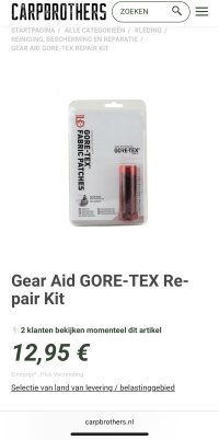

I put a small patch on the hole but it has worn through already.

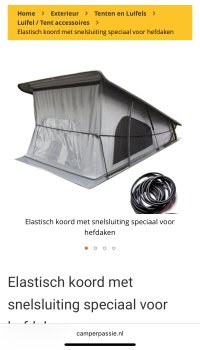

A bellow bunge will help prevent this, as helps the fabric folding in.
Also very important that at least 1 door or tailgate is open when you close the roof.
If you lower the roof gently you can see the fabric folding, it you notice its not folding in, try to pull it in place internally, or, go outside the van and slide your hand in the gap to push the fabric in, if you need some height to see, stand on the top of the back wheel.
G'day. I have the same problem - single driver, floppy bellows - and that's just the van. Solved it with home-made 'bellows bungee'. Raised the roof, measured around the bellows at halfway height and bought length of bungee cord, say 5mm thickness, to suit. Knotted the ends together centre of the back. This applies tension to the bellows as the roof is lowered. Chose a colour of bungee to match the van, very discreet etc. Recently re-tensioned the bungee due to ageing by re-knotting.
