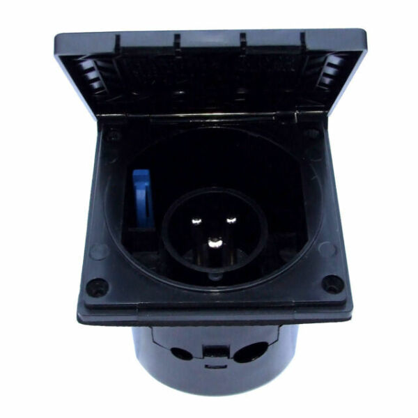

This was what I bought - £11 - you can see it has a nice new flap
First thing to do is undo a small screw on the new unit and pull the back off.
Inspecting it it has three cable clamps (white in this picture) where you can trap the incoming wire to hold it firm, so you need to choose which way the cable will come in later.
In the centre are 3 holes - the top is the earth, left is the Neutral and right is for the Live wire .
