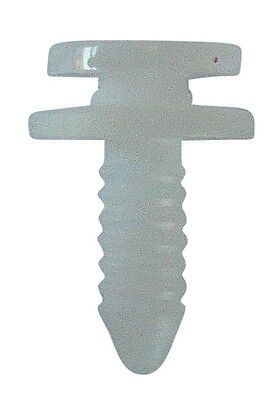

Thanks for posting this, I know its a bit old but do you know where I can get some of the whits clips labelled 11 in the first pic. Thanks for any help.
Halfords do a car panel fixing kit, or eBay, I have a load of yellow ones for a caddy, the important dimensions are the diameter of the hole they locate in and the depth from where they slide into the panel and the flange

Hi They are Part No. 3B0867333 available from ebay or anywhere by Googling the Part No. e.g. here

Thank you, I just was going to post are these the ones :
