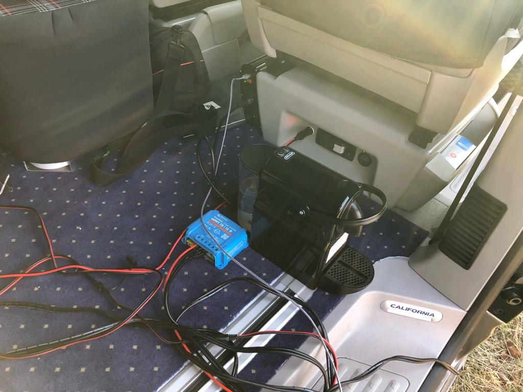

Installed a 1500W power inverter - advisable?
Current is around 4.8~5A, for periods of 25 seconds
5 amps at 240v = 1200 watts, but 1200 watts at 12v = 100 amps, equivalent to turning the starter for 25 seconds. The main vehicle battery would be designed to do this (not for long periods though); but the leisure batteries are not designed for high power outputs.
Try a Moka pot on the gas ring ... or a Handpresso.
I eventually abandoned the Nespresso machine idea, out of fear of damaging the leisure batteries.
I left the inverter assembled, but opted for a 12V Handpresso like you recommended!

MCh1777, my Cali is the pre-facelift model, no built-in inverter. I know because when I tried to use the 220V socket and it didn't work I went searching for the problem - blown fuses, etc. only to discover my model does not have an inverter built-in like the following facelift models.:headbang
Also 150W would not be enough for my MacBook, I did the math! :D
And I'm from Portugal, we use the "Euro" plug here, hence ordering the inverter from Germany and not ebay UK. :)

I also mount power inverter 3000W/1500W but I
added a second 110Ah gel battery to which the inverter is connected, the battery recharges only with solar panel
