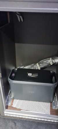

Hi Folks,
I'm going a slightly different route as I don't require power to the 230v habitation sockets, just an extra day or two from the batteries.
I'm placing a DJI power bank 1000 V2 ( no affiliation, just what I have) in the boot area under the external shower. It should also fit into the cupboards under the bed.
Inputs:
The 230v charging cable is plugged directly into the 230v socket in the boot. When the van is on EHU the power bank fully charges in 1 hour. This makes for convenient charging.
Also a 12v cigarette charger is plugged into the 12v socket in the boot. A voltage sensing relay is used to ensure this only gives an output then it is above 13.6 (i e the van is running). This trickle charges the power station at a maximum of 100W while driving, the fridge uses around 30W/hr... So around 70W into the battery/hr while driving. That's 14.5 hours driving to charge the battery from 0 to 100%. This is obviously not practical so you need to ensure you leave the house with a fully charged power station. This way you should still arrive on site with the battery at 100%.
Output;
For the output I plan to use the 12v on the power station.

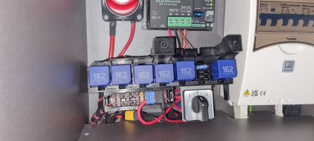

I will remove the fridge fuse (15amp, position 2) in the technical cabinet, and place the 12v feed from the power bank into the take off side (lower pin) of the fuse holder at position 2 using an electrical spade. To maintain electrical protection to the fridge I will install an inline 15 amp fuse.
In this manner the power station runs the fridge and only the fridge. My ambient temperatures are not that hot, and I should get 3 days from the fridge. Driving for an hour will add around 2 hours of fridge run time, not brilliant, so you ideally need to plug into HU after 2/3 days.
Now that the AGM battery is liberated from the fridge it will power the lights for a few days (as long as it's not illuminated like a Christmas tree). I have solar, so on good days (without the fridge running) the battery is back to 100% by evening anyway.
If I need 230v (which I never do) I could take it from the power station, nothing that it will drop fridge run time.
The other advantage for me is that we use our camper at sporting venues over long weekends. It's very simple to unplug the two inputs and one output from the power station and bring it into the venue, an hour later it is fully charged and ready for another couple of days if needed.
I intend to put a manual change over switch on the 12v supplying the fridge, so I can swap between the AGM to fridge or the power station to fridge. This just gives me options if the power station is low and the AGM is high, or if the power station has been temporarily removed.
One of the advantages of this is that you are not interfering with any of the original wiring, everything is reversible. You are not discarding the AGM battery, not having to worry about lithium in the engine bay, you have the use of a power station for other applications at home etc. and it's 'relatively' cheap. Power station with car kit costs me €620 euros.
I will report back towards the end of November with pictures and results.
Just a quick update on my install... The DJI Power 1000v2 is now installed. Please see photos attached. I ran the fridge just in the power station and it ran for 60 hours. However, this was over a cold period, the van was not heated and the fridge was only opened a handful of times. I will give it a proper field test shortly. I plan to run the fridge and other auxiliaries on the original leisure battery at night, this is to deplete the battery so I will have somewhere to sink the solar voltage during the day. During the day my lights will be off, most probably the heating, and I will run the fridge off the power station. That will means that the existing leisure battery will not have any draw during the day and will be recieving and storing all the energy from the solar panel. During a good sunny day I hope this will top back to the battery to full percentage. The power bank should be able to keep the fridge going for at least 36 hours (3 x 12 hour days). At the end of this period I (depending on sunshine) would hopefully still have a full leisure battery that can take me another circa 48 hours on its own... But the proof will be in the use.
In terms of installation it could not be easier. 1 wire and 1 fuse...I tapped a second ground wire from the solar charger regulator (battery - terminal), this is just to peg the power station 12v to the leisure battery 12v (without the common ground they can float apart). Alternatively you could use a chassis point for this, but in general this is not used in modern vehicles as it can prompt rust and cause bad earth issues. The second thing you need to do is remove the 15 amp fuse for the fridge and install a fuse tap. In this you only place a fuse in the top holder, this will be fed into a changeover switch. The second feed into the changeover switch is from the 12v output of the power station (again this is fused with 15 amps). The output from the switch is fed into the bottom lower connection on the fuse tap. This provides power to the fridge. The fridge will use it's existing ground.
To charge the unit I ran a mains cable from the rear 230v socket to the power bank, and also a 12v (100w) car charger to the power station. The car charger for DJI turns off at 12v and is not adjustable, this is too low for the leisure battery so I installed a simple voltage sensing relay. This turns on at 13.3v and turns off at 13.1v, thus preventing discharge of the leisure battery into the power station. The advantage of this, is that when the leisure battery reaches above 13.1v on solar or will also start to top back up the power bank. TBH, I do not expect much if any solar into the power station, as the solar could not keep the leisure battery top up on its own, let alone adding a second battery.
The advantage of the system.
1. Relatively chip at 650 euro
2. Very easy to install.
3. Keeps all original wiring standard.
4. Can be reverted in 30 seconds.
5. Should keep the camper off grid for circa 4 days.
6. Power station can be fully charged in 1 hour (by plugging the camper into shore power or removing the power station and charging remotely).
7. Access to moderate amount of 230v electricity if needed (I don't).
8. Fast charging USB devices - 100W.
9. Temporary power supply for house during blackout.
Disadvantages:
1. 650 euro..a 100k camper should have better system from factory.
2. Additional 15kg, payload on GC is shocking low to start with.
3. It takes up a not insignificant amount of space in the cupboard.
4. General LiPo risks (at least this one has 19 temperature sensors and 24 fuses for safety, so I'm not concerned).
5. I will be powering off the fridge each time I change between leisure battery and power station supply, while this is probably not required it eliminated the possibility of a current surge on changeover.
