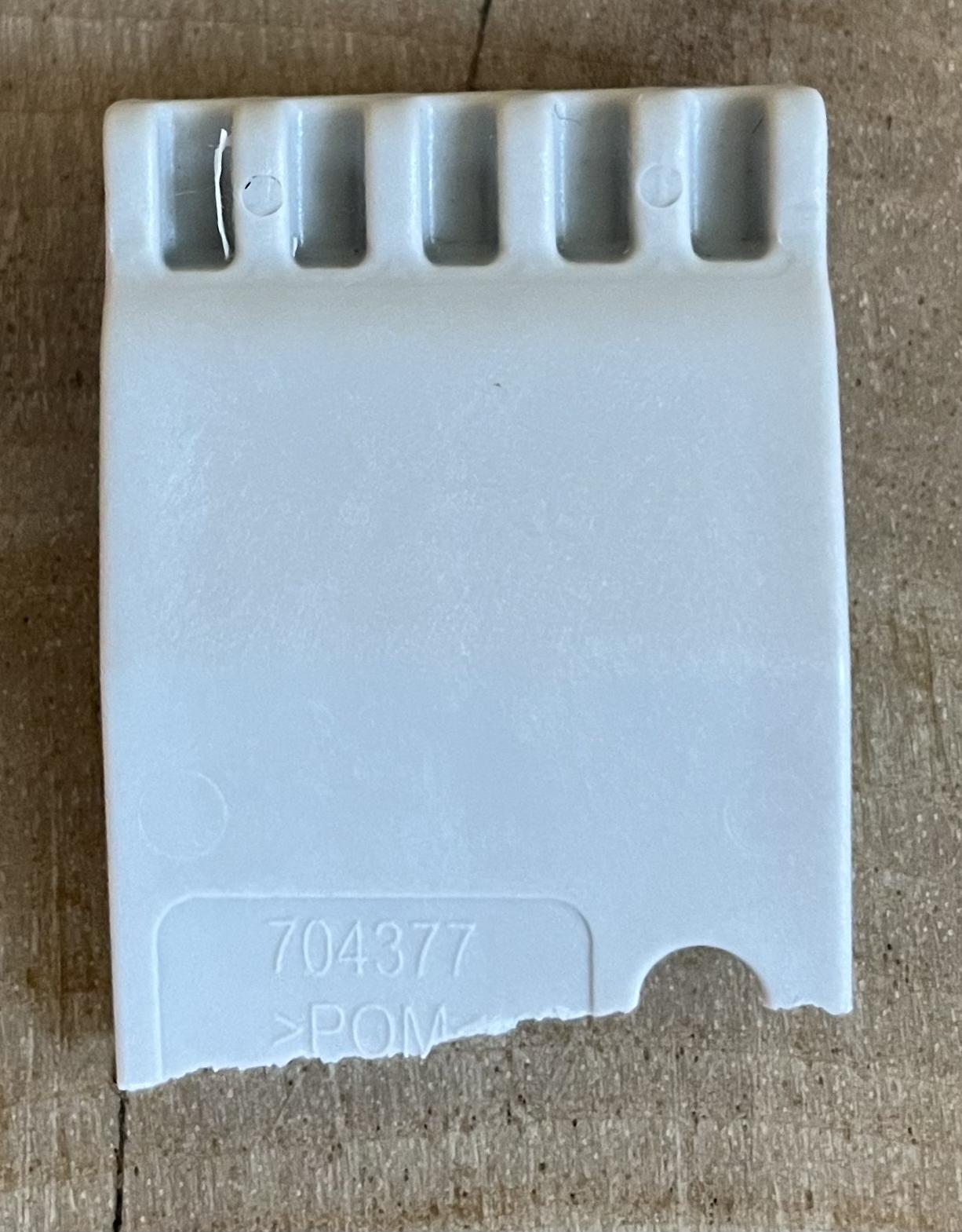

This is the bit of plastic I found towards the rear or the van (? from rear wardrobe when using doors with a bag inside against the door). Still haven’t spotted where it where it belongs + haven’t missed it!
