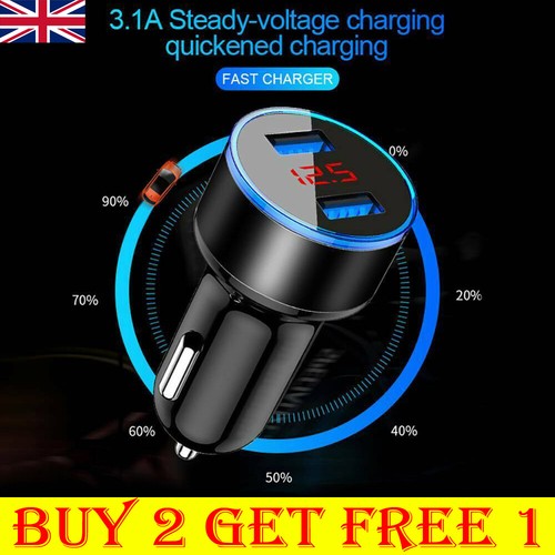

I keep one of this type adapters to plug into the front dash socket just to check engine battery level.
Mine usually gives a low voltage warning a shows 11.8V before starting. Instant display charging level once started.
