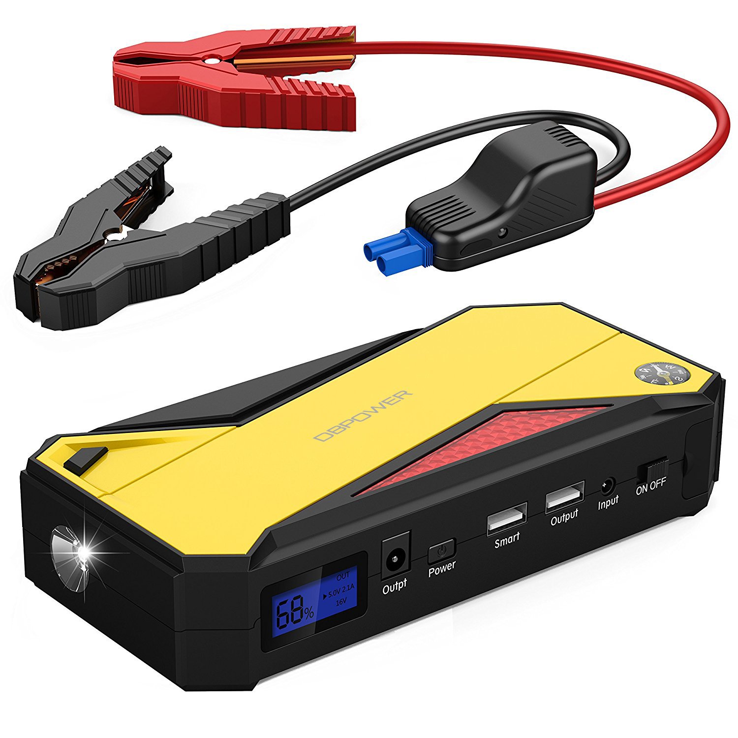

Or better still buy yourself one of the new li-ion jump starters and leave it in the glove box.
If it is flat when you return, use the key to manually open it and use your jump starter to get going.

5. I like the li-ion charger, but I assume it would require external AC power.
Much appreciated guys.
You charge it up then It stays charged for months.
I have this one;
http://amzn.eu/5Ml7bNq

Amazon does not come to South Africa.
However, we are going to the UK, get one of these magic chargers over there, pump it up nicely with fresh UK power, bring it home and viola, start the Calli with our new li-ion charger if needed.

I know you are 'in the business' but might you not have a problem getting a charged li-ion charger through airport security?
See Post 13 above.:thumb
