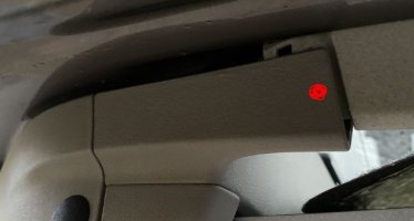

The 2 sections interlock via metal clips on the inside of one section.
Once the original joint is split then it seems that the 2 sections are more prone to come loose the the plastic seam on the other section is now weakened - resulting in the gap shown in your photographs.
A sharp knock with your hand will push the 2 sections together. But the repeated action of opening and closing the tailgate is likely to open up the joint again.
I am considering using plastic rivet pins to hold the sections together. This will mean drill holes through the 2 sections though.
That’s really helpful I will try that in the morning, where would you drill these holes and how would you attach it ?
I need to check the exact location for the best fixing point, but somewhere here each side. I need to make sure I have good plastic to drill through in both pieces.
I have some of the plastic removable pop type rivets that are already used on the inside of the tailgate trim.

That’s makes sense. So I have been banging the trim, it’s closed up at the points you marked, but won’t close up along the sides or at the bottom along the window, so again think dealer has not done it correctly. Out of interest where the wiper is does the trim completely fit to the window or is there always a gap there. Seems wider than of the window trim gap
