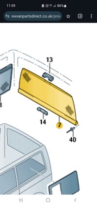

That's the clip to hold the Tailgate blind down when stored
Part 14.
The Blind handle would be clipped in that clip and you pull handle out and up to top of window where it clips into a hook type clip, Part 13.Screenshot_20250424_115931_Chrome.jpg
