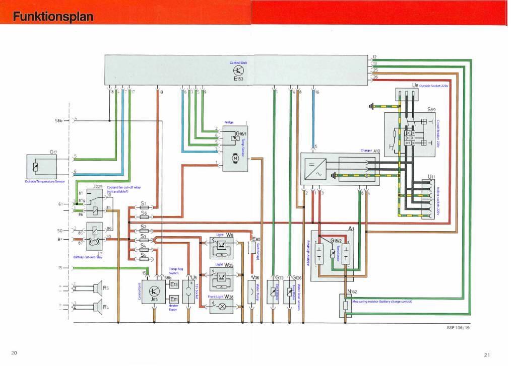

If I’m reading this diagram right, yes it will work.
