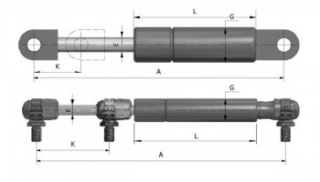

It’s likely that you will need updated roof struts for the coasts manual roof, otherwise the roof will sag when the rack is fitted:
Item number : 8.96.311
Force (Newton (N)) : 600
Bracket piston rod : Ball- and socket joint
Bracket pressure tube : Ball- and socket joint
Brand : Hinscha
Reference : T5/T6 California 600N
A - Length (mm) : 956
E - Ø piston rod (mm) : 10
G - Ø pressure tube (mm) : 23
K - Stroke (mm) : 440

Yea good call, I will see how it goes first, the rack should be 25kg and I would remove anything on it before lifting so within 50% of the max load for lifting stated at 50kg.
