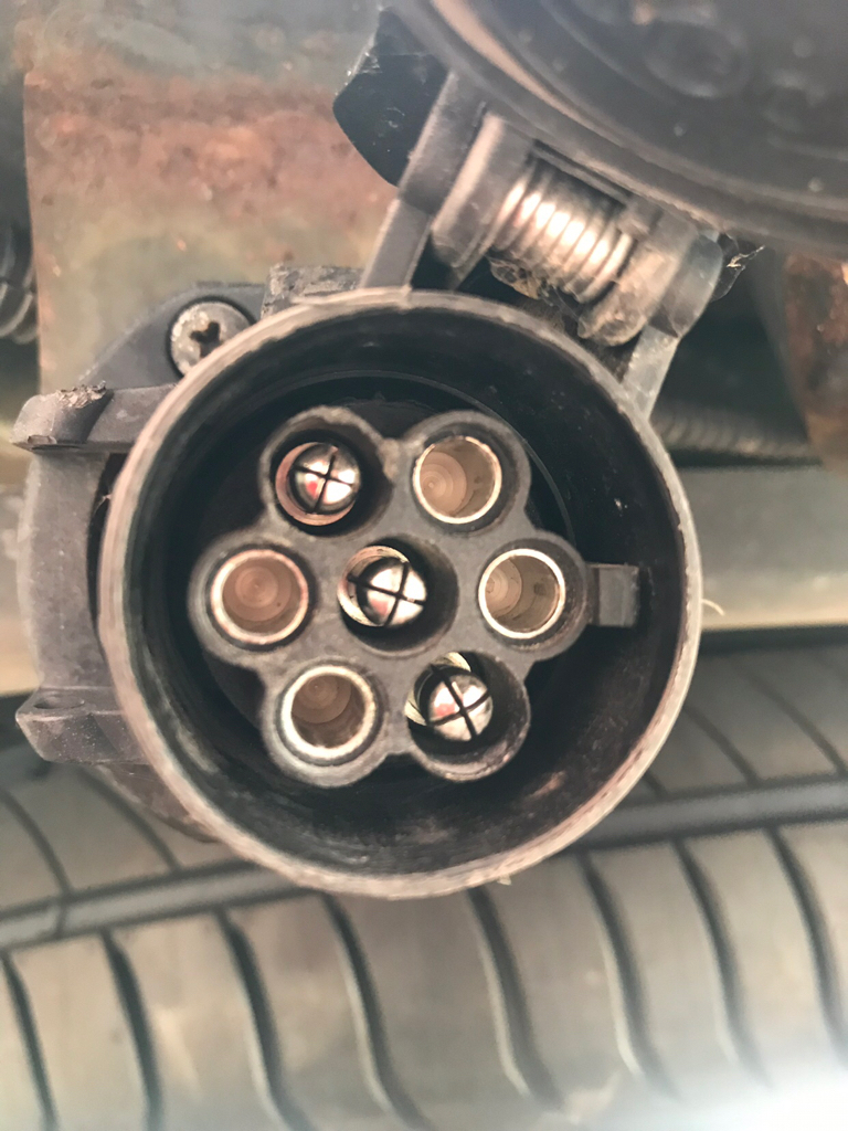

My 2010 T5.1 has failed its MOT due to the Fog Lamp not working. Fuse 17 (my list of fuses indicates this is the fuse) on the central internal fuse box has been checked and is ok. Bulb is ok, but there is no power at the bulb connector.
Last week I was towing, no idea if this could be related. I have factory fit tow bar and lights.
Any ideas, before I take it to an electrics tech.

If you look inside the Towbar Socket, there is a Little microswitch which is depressed when the Towing Plug is inserted. This switches Off the Fog Light. This can get stuck on. Some WD50 and a small screw driver to pull it out and then press a few times until it pops out on its own. Sorted.

Have had a look but can’t see it. On the attached photo are you please able to indicate where the micro switch is ?
As indicated they are factory fit electrics.

You have the older 7 pin electrics. Do you have a fog light on your trailer?
The operating pin on my 7-pin socket is on the lower edge of the socket right at the back.
The outer side of the plug pushes it in.
You may well need to get on your knees to see it.

Here's the switch on mine (fitted 2006) that welshgas is on about.
It won't help you but yours might have one somewhere. 47629

The VW has 13 pin, I have a Thule 7 pin adapter which has been on since 2010. It has never been off and unfortunately now won’t come off. I assume this adapter would in itself disable the fog light by pushing the micro switch on the 13 pin, in ?
If so, this would mean that on every MOT since 2013, all carried out by the same place in Plymouth, the fog light issue has not been noticed. Now at the same Firm, but their Abergavenny branch, it has been noticed, hence the MOT fail.
Will try to get it seen to tomorrow, and then get an MOT pass.

That would explain it. The adapter has depressed the switch. If it cannot be removed then you might need to replace the 13 pin socket.

Yes, that would be the reason it is not working. You should not leave the adapter in place. I am surprised this hasn’t been spotted by the tester before, although maybe rear fogs were not in the test until recently.

Managed to wrestle the 7 pin adapter out and on came the Fog light. As it’s been in situ since at least 2011, it shows that the non working Fog light has not been noticed on all MOTs since 2013. Has now passed its MOT.
Off to Hereford in the morning to get a new 13 pin socket fitted & to get a 7 pin adapter.
