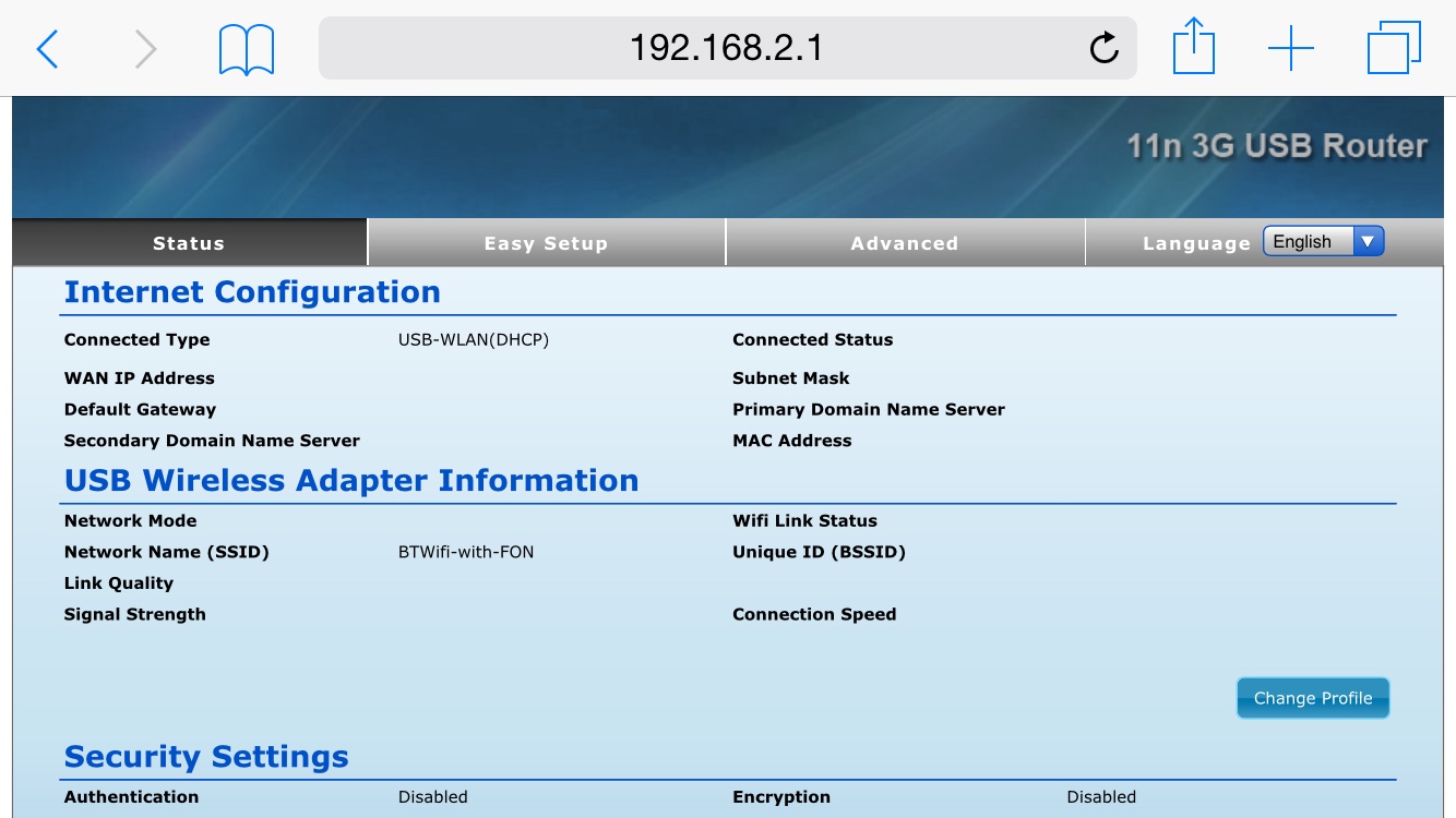

Parts arrived and we have spend hours trying to get the buggers to work :headbang
The router works fine, the nano works fine, they both light up, connect together and link up and I can scan wifi networks and join them and have good reception but no matter what we try it just won't connect to the internet:headbang:headbang
Any ideas?

You need to set the nanostation up as a router, and the mikrotik as a bridge. That's how I did mine and it seems to work ok. If you struggle, send me a pm and I'll try and send you some screenshots. Unfortunately I'm really busy on the campsite just now so you'll have to bear with me for a reply.
