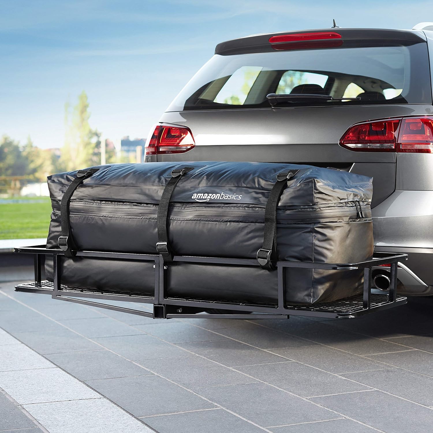

You say you're not sure how permanent the solution will be. Perhaps the storage bag below might suit you. It has plenty of room and is said to be quite sturdy. Just put it on the folded down bike rack. There are several people on the forum that use it. Also, you can use it when you need it and leave it at home when you dont ot when you prefer to bring bikes. Perhaps it doesn't tick the 'cool looking overlander jeep look' though.
