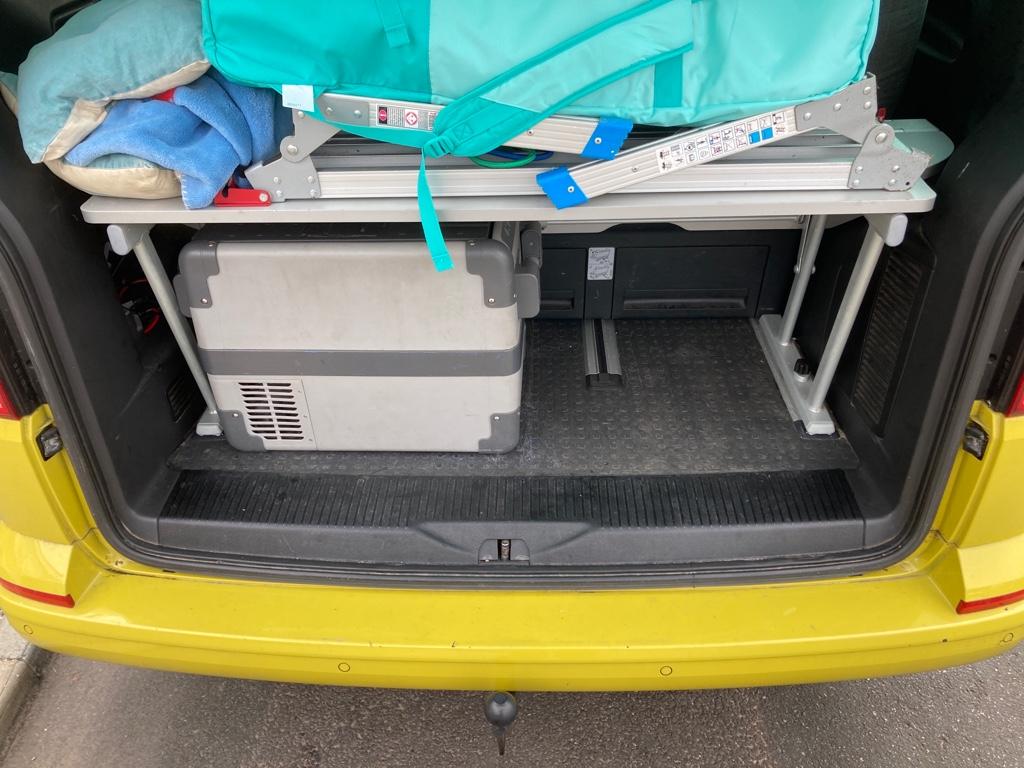

Whatever the problem, here’s a photo of our Beach with the multiflex in the rearmost position.
