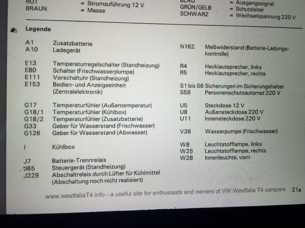

Think the one in the engine bay is the external temperature sensor for the Central Electronics display. G17 is the temp sensor to control charge rate?

G17 is fore the outside temperature

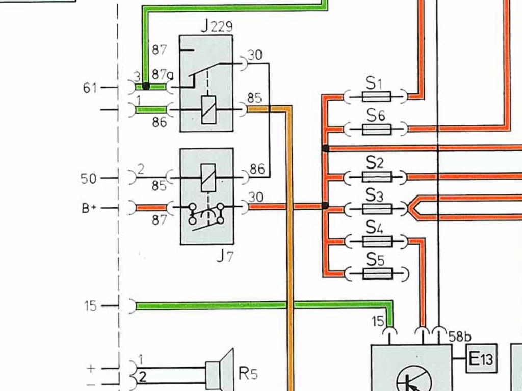

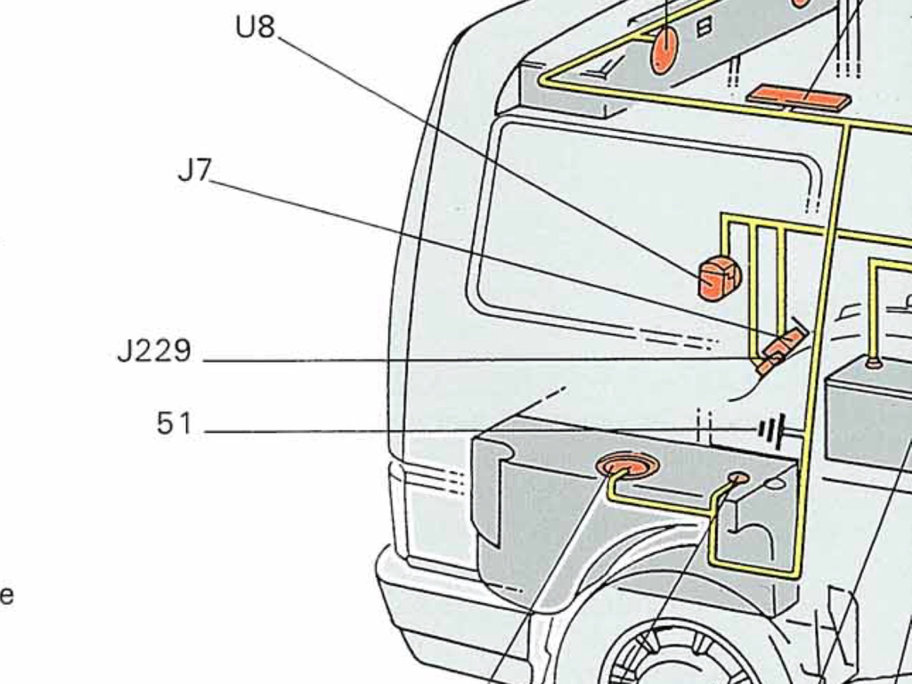

Indeed it is. Just double-checked sidepod's wiring diagram.
I have come to the conslusion that it must be for the j229
Is seems that it is not installed but just prepared for a later install
