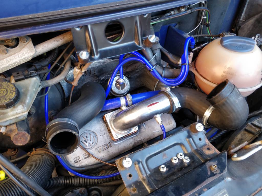

I've just fitted a turbo to my AAB syncro back in the UK and it's transformed it. The thread on the T4 forum is brilliant. Turbo, manifolds and other bits and bobs off an ACV. I can now get up hills no bother at all now.
Sent from my ONEPLUS A5000 using Tapatalk
Some tea leaf knicked your intercooler!
