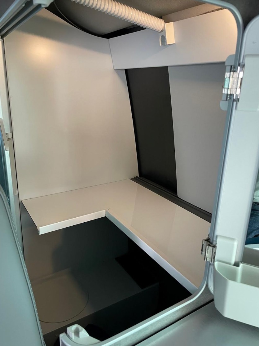

Shelving for wardrobe
It doesn’t need much just one extra shelf, available at the shop.
