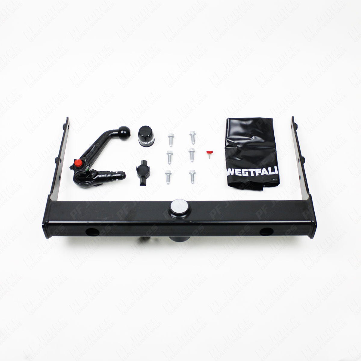

Which type of tow bar do you have, as that makes a difference

As well as the maximum vehicle nose weight, the tow bar itself will also have a maximum nose weight.
www.pfjones.co.uk/towing-weights-explained.html
Didn’t think of that! It’s the removable type
If you have a detachable Westfalia then there is a noseweight limit of 60kg when carrying an unsupported load, such as a bike carrier.
Not sure if it matters but to be specific it’s the VW version of the detachable towbar
Can you provide a reference for this statement pse @Mr T . Can only find reference to 100kg nose weight limit for that specific bar. Think the factory fit option ‘Towbar – removable and lockable’ is the Wesfalia? Be disappointing if it is 60kg for bike rack on the factory fit, may have to rethink the bike carrying solution.
I was informed of this when looking to get a tow bar fitted. Westfalia issued a statement to approved fitters regarding this revised nose weight limit.
Thanks. Just checked the PFJones website which doesn’t offer up any limit other than the 100kg nose weight for the Westfalia but does state that it can take all bike carriers. Seems like a fairly fundamental detail that needs to be understood; there must be 1000s of people driving round with 4 bikes (c.13-15kg each) on a rack (c.20kg) just as I intend (intended!) to do. So clarification from VW required; I’ll see what they have to say.
Yes there doesn’t seem to be an unsupported load mentioned, only an S load I think they call it. I went to Phil Taylor Towbars on recommendation from others on the forum, I asked for a Westfalia detachable and they would happily fit it but asked if it was for a bike carrier, which it was so they brought to my attention the statement issued from Westfalia regarding this unsupported load maximum. So I went with a Tow Trust detachable which has a 100kg unsupported nose weight.

The fitting instructions appear to indicate 60kg max for bikes, but it’s a little unclear:
Good spot. Seems to say max. 60kg of bikes which ties in with the Westfalia (and also the likes of Thule) bike rack max. payload; and implies the weight of the bikes is in addition to the weight of the bike rack itself. Which is fine and as expected if that’s the case, but as you say very unclear.
I wonder if it’s the cantilever action of a bike rack which puts more pressure on the ball connection with a turning motion were as as trailer/caravan just applies a downward force close to the mounting on the vehicle
The following is from VW customer care in response to my query:
Thank you for your patience whilst I obtained the information you requested.
I can now confirm that the detachable tow-bar nose weight does reduce from 100kg when using an unsupported load such as a bike carrier, the lower nose weight being 65kg.

So that adds another number into the pot, but doesn’t help me with 4 bikes and a 20kg rack. Would really have been useful to have that info available at point of order, and before I invested in a Thule XT3 and 4th bike attachment. Be interesting to see if they come back to you with same info @JandA but it looks like it’s back to the rear door rack for me; fortunately hadn’t got round to selling it!
