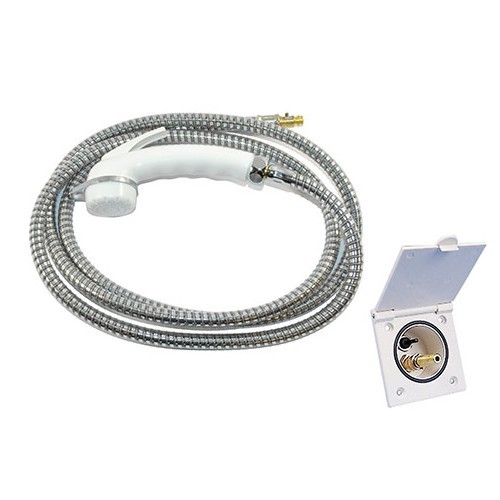

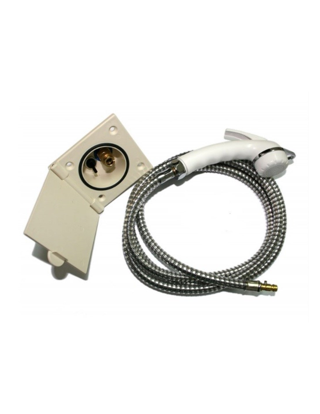

OK, for those interested and following this tale (!), and in respect of my original question about simply replicating the OE cold shower, I just called a chap at a conversion co. ('T5 Alive'), who tells me that the factory-fit shower indeed uses the very same pump as the galley sink.
So, he says all one need do to replicate the OE system is to add the rear bulkhead fitting (he suggests 'Bullfinch, which is 'exactly the same as Reich'), tee the outlet of the existing pump, run a suitable hose from the tee to feed the bulkhead fitting, and connect switch to pump. What he wasn't sure about is whether the standard loom will or won't have a connection waiting for the switch to be connected to it - 'probably not' he thought, saying 'they build that stuff in by hand so probably just splice into the loom'
(I cannot at the moment find the Bullfinch part to which he refers, so here is the Reich ass'y, which appears to be a version without switch - stand by for an update!:
OK, HERE IS THE CORRECT ITEM (Euro 89.85):
Yes, that linked item looks to be the same as we have on our 6.1 Ocean.
And here it this parts list- best to check that these are same for T6.1, but I suspect they are

For those following this latest instalment of the 'DIY-fit my own OE shower system' story, I got a quote today (see below) from my local dealer for the complete OE kit, the parts list for which (also below) was kindly provided by BenPcaliman in the thread running a couple of years ago.
If any of you suffer from dry eyes, the VW quote will surely sort you out! - the genuine Reich bulkhead fitting and 2m shower hose+head I ordered yesterday for E68.48, is a whopping £128.10 from VW!
As for a length of water hose at £9.34, a 10mm plastic Y-piece at £6.87, or 2 hose clips at £9.78, all PLUS VAT of course, I'll procure my own plumbing sundries, thanks very much VW!
