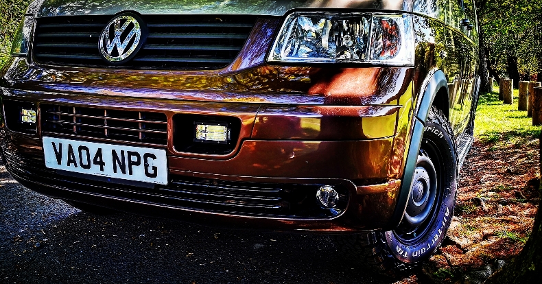

Hi,
My van is a pre face lift, i fitted these in the bumper. Surprisingly bright...

Nice, what do you run them as ? Fog or maIn beam or ?
Link to where you can purchase ?
Hi,
I got them from hrre, i think they are flood rather than spot...
Also got the wiring harness. About £30 or less Inc the harness..

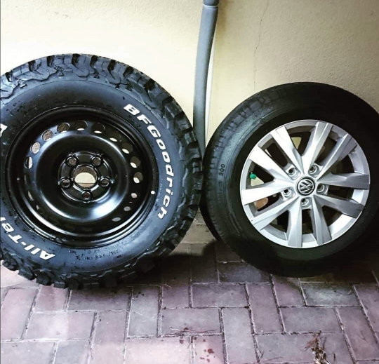

On a slightly separate note, what size BFGs and weight rating have you gone for please? I'm just about to go down that road.

No Problem, if you have or know somebody who has Blue Light card.
You get some money off.
I got the lifetime warranty on them.
so any punctures, damage or anything , they replace the tyre up to 3mm
They come with 14mm tread.
Also they will put you up in hotel in Europe for 3 days while they source and fit a tyre.
My mph is perfect now compared with Waze sat nav.
cheapest and filled with nitro.
Also free swap from front to back twice a year.
And free monthly top up with nitro and pressure check.

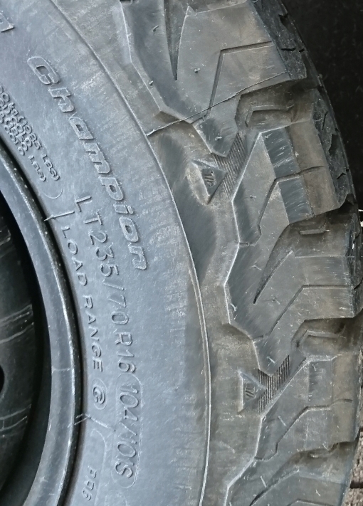

Hi
I have BF Goodrich All Terrain K02 tyres in 235 70 16 size on stock satin matt black steelies and stock suspension.
They are 104/101S rated, depending on single or dual wheel axle, obviously, a T5 is a wheel each side, so 104 for ours.
My van is a T30 LWB 2.5 130 and weighs around 2750 kgs..
Max axle weights for a T30 LWB T5 are:
Front 1575kg
Rear 1625kg
T32 is :
Front 1650kg
Rear 1720kg
Tyre load numbers:
101 = 825kg
102 = 850kg
103 = 875kg
104 =900kg
So, max rear axle for example 1625÷2=812kg, the BFG are 104, so are in excess of the max axle weight.
They would also be fine for a T32.. As always, check your own sums, and inform your insurance broker...
Hope that helps..
Alistair
