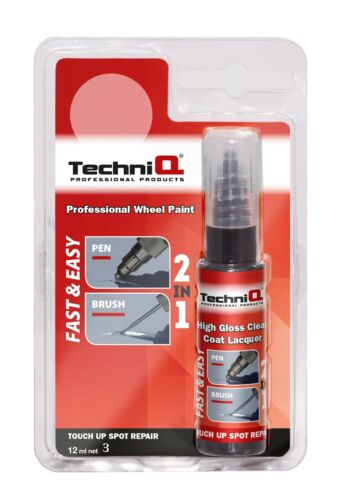

You are suffering from the usual Diamond Cut finish failure which can only be professionally repaired.
Any attempt to rub /sand it out will make it worse as you can't get the Diamond Cut finish only a polished alloy one at best.
You might have some success with this kit, worth a try possibly
