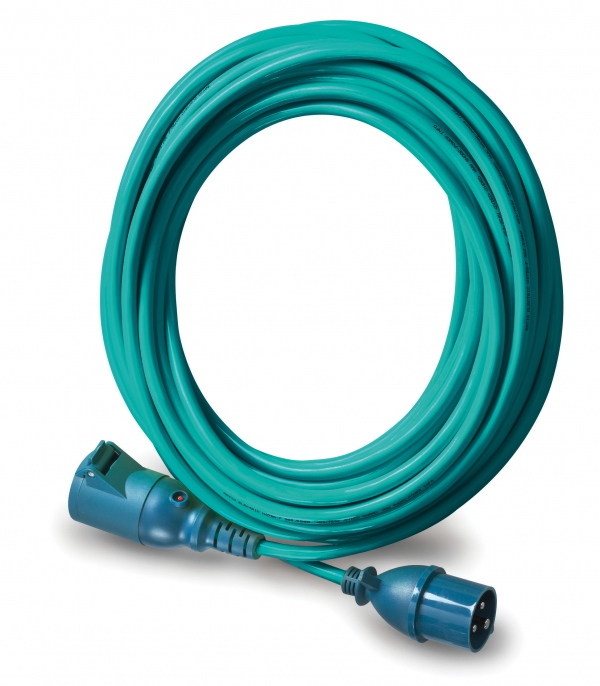

This is what I use,
Positives, easy to wind never any kinking in cold weather, LED power indicator,
Negatives heavy and expensive.
Mastervolt. They also do 15 meter.
Connection cable 25 metre 2.5 mm²​
  • UV-proof and wear-proof
  • Moulded plugs
  • Integrated LED power indicator
  • 2.5 mm2
