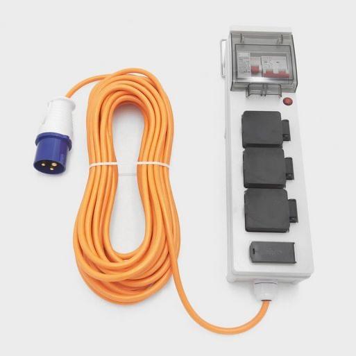

Power cable
They normally have 2 ratings printed on the spool. One for wound, one for unwound.
…but some people tend to ignore this and then wonder why the cable is very warm!
Some reels have 2 ratings, and some newer and larger models have a thermal cutout. In my experience most that are in common use have neither. The ’wound up’ safe rating for say a 25m reel with decent cable about 1.25mm2 cores is typically around 700 watts, so not a lot.

After trying all options: 10 + 15 and 25m, I only take 25m in zip-up bag in underseat drawer. I like a relaxed and minimum-faff trip.
Not i)worrying whether the site manager will object to joined up cable ii) in heavy downpour is IP44 "Protection against splash water from all directions" really enough (I think not), iii) should I go out and lift the junction off ground and cover (an act paradoxically putting you at greater risk).
The cable doesn't take up much space in simple coiled form, is straightforward to handle with a little care using purpose designed zip-up bag from camping website.
In practice, I seldom use it anyway. Not needing EHU will sometimes get you on a most lovely pitch or into a site otherwise full. We are mostly touring and the batteries will last two or three days between a longish drive.
To be fair to CAMC, site manager who spotted my joined cable let me use it but for couple of days only, but I had the 25m for the next visit.
Just get 25m, coil it consistently, relax and enjoy.
