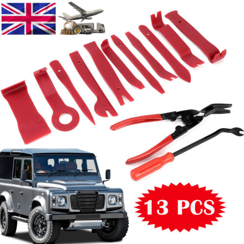

Also found one of these kits pretty much essential. Off Ebay though not amazon.

I finally used a Trim Removal tool (see photo, 5mm thick down to 1mm at tip) as suggested by Moor288 and BJG.
I turned both front seats round, measured and marked the tab positions, used the trim tool to widen the gap between the 2 headlining sections, I then stood on the seats with my back to the windscreen and pushed the Tabs into place. It still required a fair amount of force but they went in which is the main thing.
