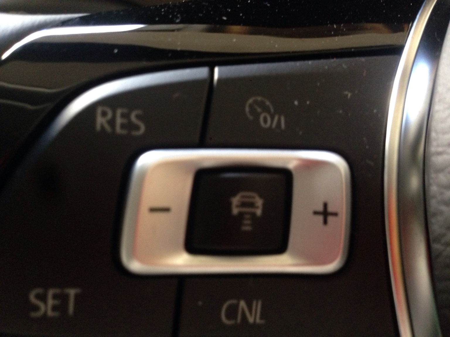

  1. the adaptive cruise control :
how do you get it to speed up in steps of 10 km/h (i have the multifunctional steering wheel )

Question 2
Press the + or - buttons to increase decrease by 5mph
Mike
thanks a lot mike ,
i thought this was only to set the distance of the ACC
Will try this out this evening .
thanks a lot mike ,
No problem. Pressing the ok button changes the distance and pressing + or - the speed. So if on you have set to 29 press + will go to next increment so to 30. Next press gives you 35 then 40 and so on.
Mike

thanks a lot mike ,
For ACC if you press the distance button it cycles through them, if you press it and then the toggles left and right you can adjust yourself.. Yes, I know you didn't as that question but it was something that I didn't realise,

The ACC works perfect now .
